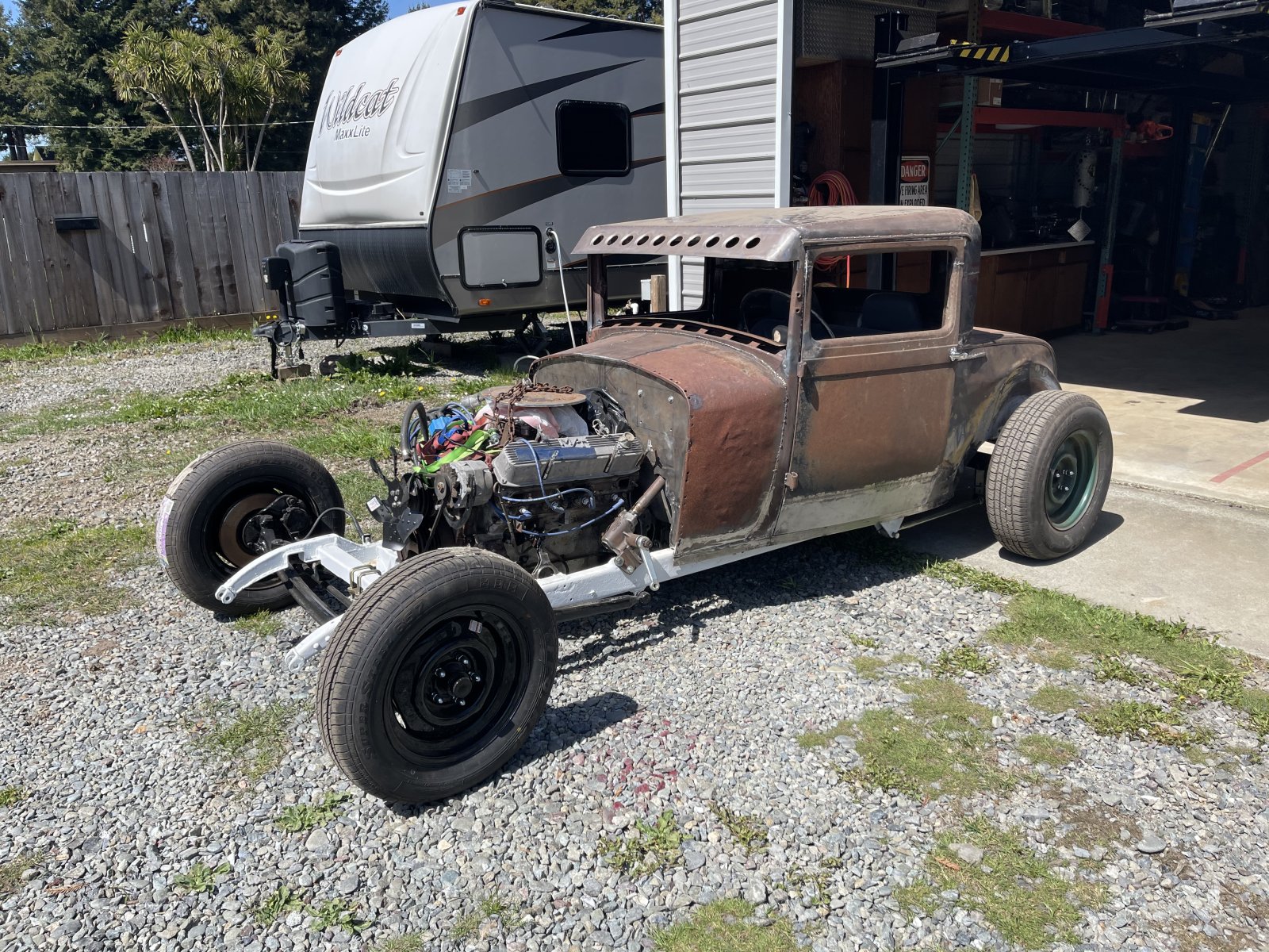

    My 1923 Willys coupe- we used 28 Ford model A truck doors. latches and handle are on.
    Is there a list or a diagram or anything that I can look at and make a list of all the parts to get the windows in , window crank up and down , guides-felts - all of it. I’m going to get all the gl*** in it so I can actually get it drivable for the Summer !’

    Those are 28-29 Model A sedan or coupe doors, not truck doors. For the window fuzzy channels I’d use the generic U type. Measure the width of the channel in the door to find the right size. Available from many restoration supply places.
