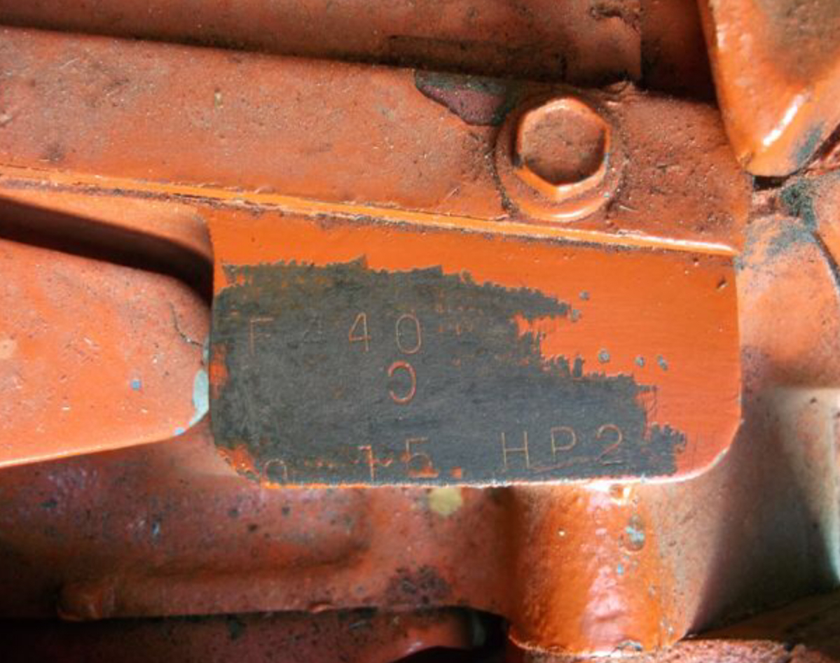

    First, let’s start with the pad on the top left front 272CDFAB-E052-402E-99F4-97107178EFB4.jpeg opposite the distributor hole. This will tell most of the story. Depends on the year of the block wether or not there is a VIN number stamping.

    The paint is awful rough looking for just been put together.

    you guys haven't figured out that the picture a few posts above, is NOT the mystery engine, right? It's an example of what to look for.

  23. Is F440,,,,,a 71 ?
    The HP2 blocks were usually 6 pack pieces,,,,,but not always .
    It got where they were using HP2 blocks in 4 barrel applications as well .
    And yes,,,,,some of those 4 barrel engines had 6 pack rod ***emblies.

    I’m pretty sure the F is a 70 model engine?
    Tommy
