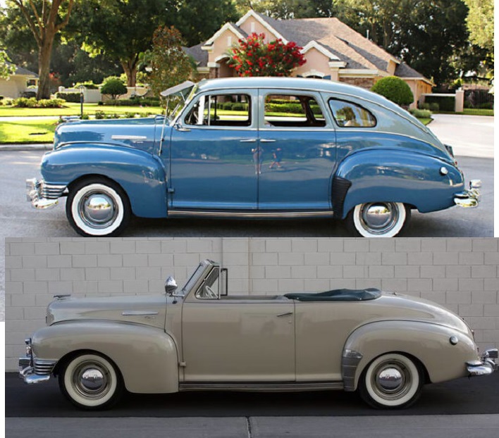

    Thanks for the replies. The information I'd found said fenders were from the 600 and cab was the front half of the Ambassador. The guy with the fenders isn't sure which model they came off of so I was hoping they might interchange. So I need to figure out how to tell them apart. Just looking at pictures the 600 and Ambassador look the same. I do know the difference between the car and truck is the size of the wheel opening. They bolted a three inch piece between the fender and the catwalk to make it wider, and bolted extensions on front and back on the bottom to make it taller. Since Nash only sold about 300 trucks in the US truck fenders are non-existent. I figure I'll be doing some metal work on wheel openings.
  7. squirrel
    Joined: Sep 23, 2004
    Posts: 59,225
    squirrel
    pretty easy to see what the difference is if you look at both of them from the side
    bigdog likes this.
  8. bigdog
    Joined: Oct 30, 2002
    Posts: 794
    bigdog
    I'll just have him send me some side view pictures of the fenders, should be able to tell. thanks.
