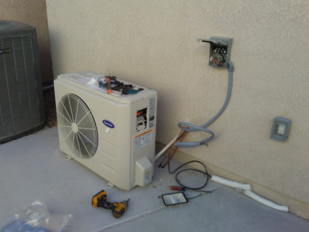

    This is mine. 20X24 split unit ,heat & AC all year long 24-7. Compact neat unit.

    Bob, that unit interests me. If you don't mind, who is it made by?

    While visiting my son in Las Vegas, he bought a unit that looks just like yours at Costco for around $1000. Poor directions but online video helped quite a bit for installation. Don't know about the cooling portion since it was installed just last month but it heats his 12x30, 14 ceiling shop with no insulation to 70 degrees in about 1/2 hour.

    Looks to me as if says Carrier.
