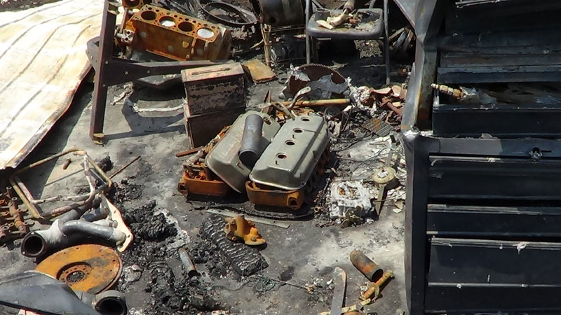

  10. alanp561
    Joined: Oct 1, 2017
    Posts: 5,632
    alanp561
    Those are people who make it rough on everyone else and don't think a thing about it

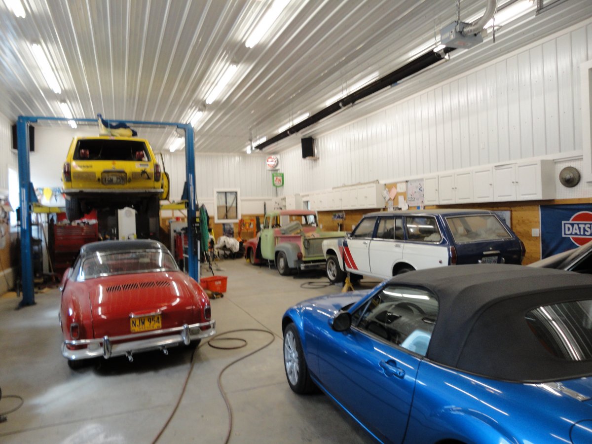

    I am finishing up the shop and using a Mr.Heater Big Max.... works very well..but my studio is not finished above the shop and while the Heater does push upstairs..I am thing of going electric.....Our peak rate is 13.2 cents per kWh and the off peak is 6.5 kWh....One of them electric units just may do the trick.... or a smaller Mr Heater..... We run on Propane. IMG_2516.jpg IMG_2518.jpg

    I have a radiant tube heater for the last 15 years and I love it.
    My highest bill was $110 for a month that was in the 20s - 30s.
    I can paint in my shop in the winter since the heater intakes air from the outside and exhausts it to the out side.
    I typically cant tell the heater is on by the sound but I can feel the warmth on my skin.
