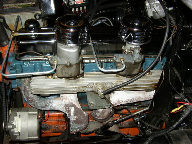

    stromberg boxv2's were the choice carb for multible 1 BBl applications, similar to a 97, there the best, there worth looking for, have fun
  9. Flop
    Joined: Jun 8, 2006
    Posts: 3,885
    Flop
    the bxv 2s are the ****. running 2 on my 216 with the adjustable high speed jets .tuned them once and havent touched them since and it has been about 6 months no leaks no problems what so ever and wow did it help the performance
    found these 2 on ebay for 40 bux a piece Nos still in the box with all insturctions and gaskets and electric chokes which is very nice!!

    thanks for some more help, heres a kinda ****py pic but a pic of the 235 I built and the intake I'm needing the carbs for.[​IMG]

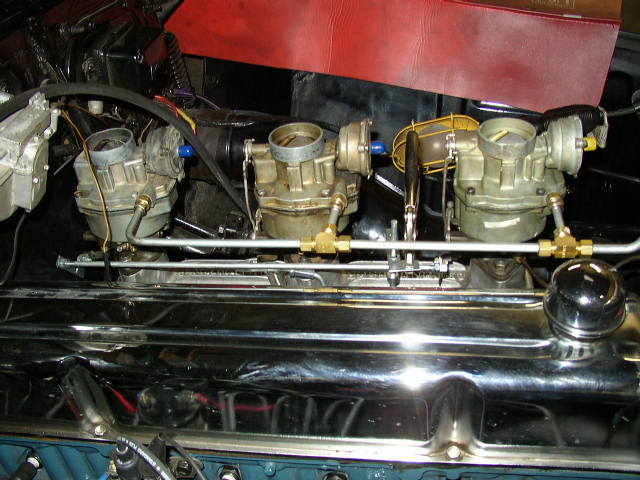

    I'm running 2 Rochesters on my 235
  24. chris63
    Joined: Jun 29, 2004
    Posts: 40
    chris63
    ok well i'm running three Rochesters on my 235 six and yes they did leak when i first put them on i found out that the floats have to be finely tune and get the extra thick gaskets that i found as new old stock at a carb shop and they are a bit tuff to keep in tune strombregs are the way to go from what i hear so when you learn which ones fit right please let me know and with the linkage
