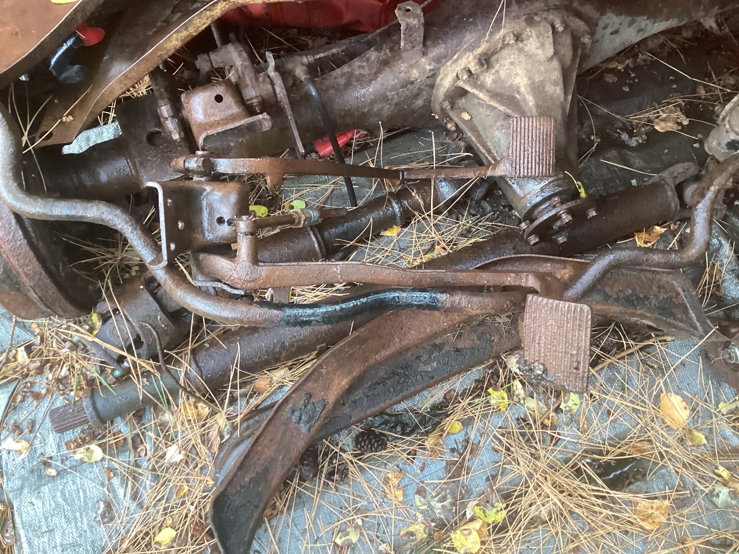

  7. jazz1
    Joined: Apr 30, 2011
    Posts: 1,601
    jazz1
    Something like these should be easy to source, image.jpg these were off 40’s pickups
