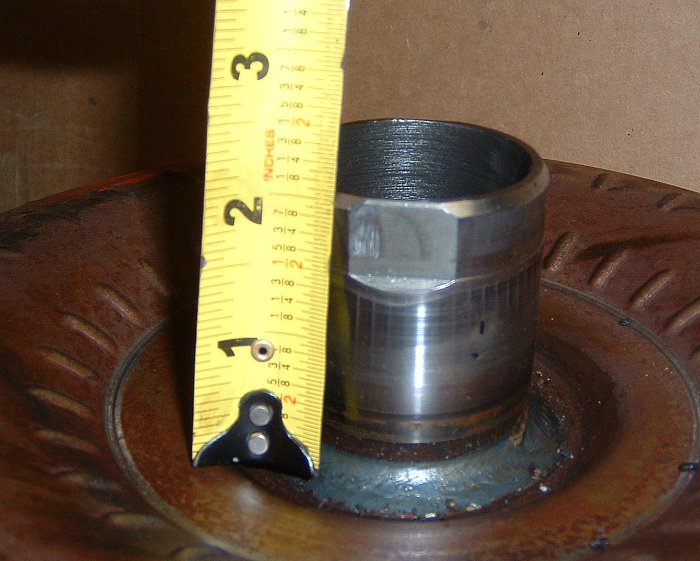

    Hope someones could help me with this. I have a 302 with a C4. Im going to use a 164 tooth flywheel, I just got a starter for it and ready to bolt together. Got it snugged up and everything fit great, but the converter needs to slide out of the trans about an inch to pull up to the flywheel. Is something wrong? or do I need to pull the converter to meet the flywheel to mate 'em together. Not real comfortable with it. Not like a GM where I could machine some spacers and bolt together. Id appreciate any help. If you need more info, let me know. Thanks everyone in advanced.

    Slide it up and bolt it on. I've got the same setup in my car ('87 302 Roller motor with a 70's C4) and had the same issue. I consulted a buddy who is a master tech, he looked at it, bolted it together, and all was fine.

    Perfectly normal. Just make sure your crankshaft doesn't have a pilot bearing retainer in it, as the hub in the converter needs to go in that hole.

    I hate to disagree with everyone else but if you have to slide the torque converter forward anymore than ½” something is wrong. Sliding the torque converter forward 1” will pull the torque converter right out of the pump.
    When the bell housing is bolted tight to the motor the torque converter studs usually bind up with the flexplate on a C4.
    I'd check with a trans shop to make sure that is the right bellhousing for your setup.

  11. Its been a couple of days since I checked back but thanks again for all your help. There was something wrong, The Bell Housing was incorrect. I found out by checking the numbers that it was made between 82'/83' for a 200 ci inline six. Bolts up fine with all my gear but is 3/4" longer than what I need. Sumbitch. I got the correct one and all is well. Thanks again folks, I really appreciate getting on here and you all giving me a hand.
