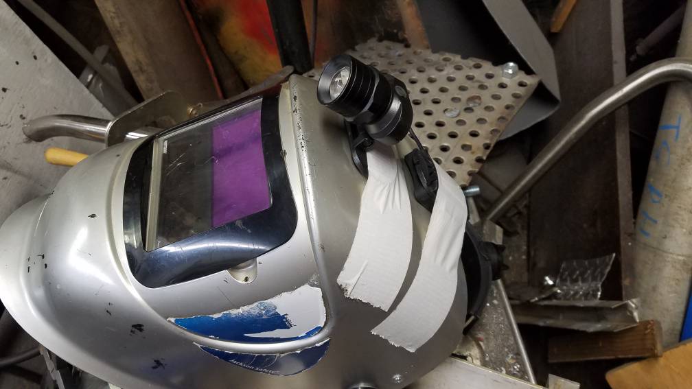

    Beanscoot
    "someone on here had a thread about velcroing a led head lamp to his helmet and stated that it was the fix for his predicament of not being able to see the puddle fwiw"
    I read that thread too, didn't he place the light under his chin on the helmet?

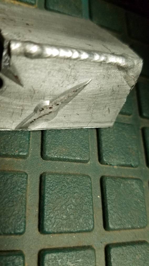

    so far I can do decent down to
    .045 before I start burning stuff.
    I think my next step is to practice slower patience and keep the heat-soak from catching me. :)
    580 lumens I think
    .045 aluminum. at little hot at the ends
