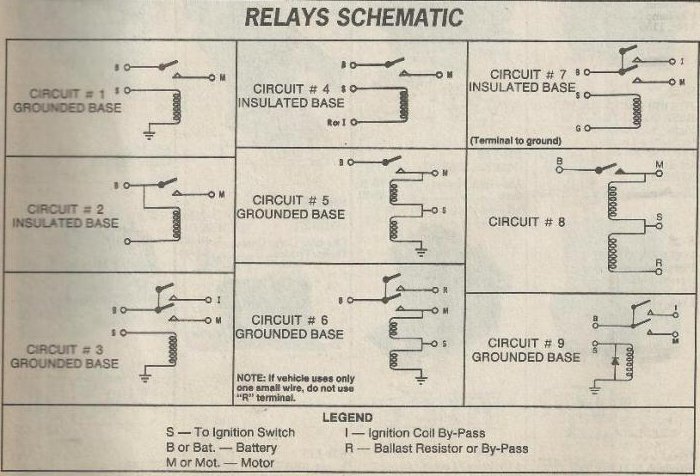

    There's no part number. I'll try sending a pic. I think the two big side bolts are Battery on the left, starter on the right, but on the top, the little one marked with an "I" is ? the ground to the ****on? and the one on the left marked "S" is ???? If you straighten me out I'd appreciate it.
  13. To make it work with the stock push ****on you need a insulated base. The SS-587 is what you need, you can give that number to the parts store and they can cross reference into a part number they have. Then it’s battery in on one side, starter out the other side and the wire from the push ****on to the front pole. The one you have might be 6v.

    Thought I was done with the questions but looked over schematic 2 and had some new ones. 1) It's hard to make out if the pole at the top of #2's drawing is a "B" or and "S". From what 1Oldtimer said I believe it should be the battery but??? If it is the batter what is the relationship with ignition? If installed in as I believe you're indicating, are the starter and the ignition separate? Thanks again in advance. (PS. I ordered the ss587.)

    Top terminal in drawing is B, only thing that goes here is battery cable and power feed wire for rest of system. Should be 5/16 stud closest to small stud. Other 5/16 stud goes to starter. Add a wire from starter ****on to small stud and it should crank over. I can draw you a simple diagram when home later, not smart enough to do on my phone, lol.

  22. In Circuit #2 the switch part is the battery and starter (the coil inside needs a ground to activate from your push ****on). You're going to lose the "I" terminal that was on the stock relay. If you really think you need the "I" terminal then you can go with a SS-582 (circuit #7), but you'll have to run a wire from "S" terminal to the battery lug on the side and your push ****on to the ground lug on the back.
    But I think you'll be ok without the "I" terminal hookup.
