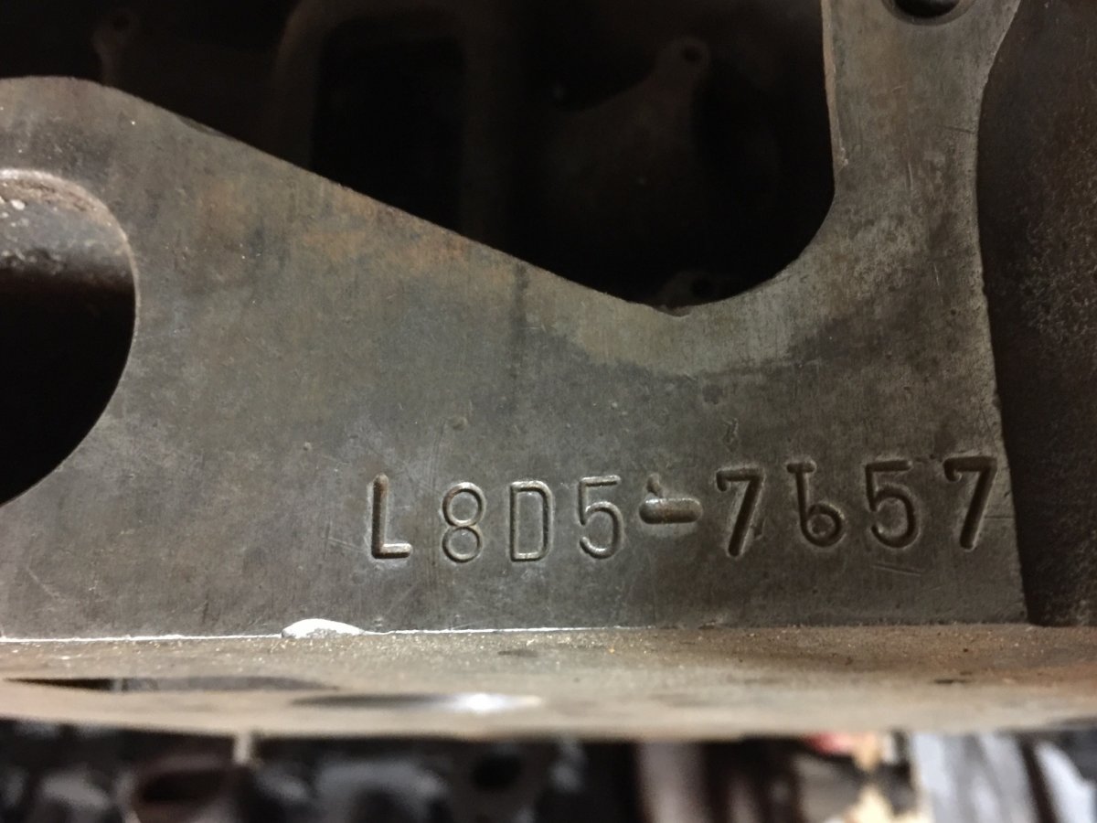

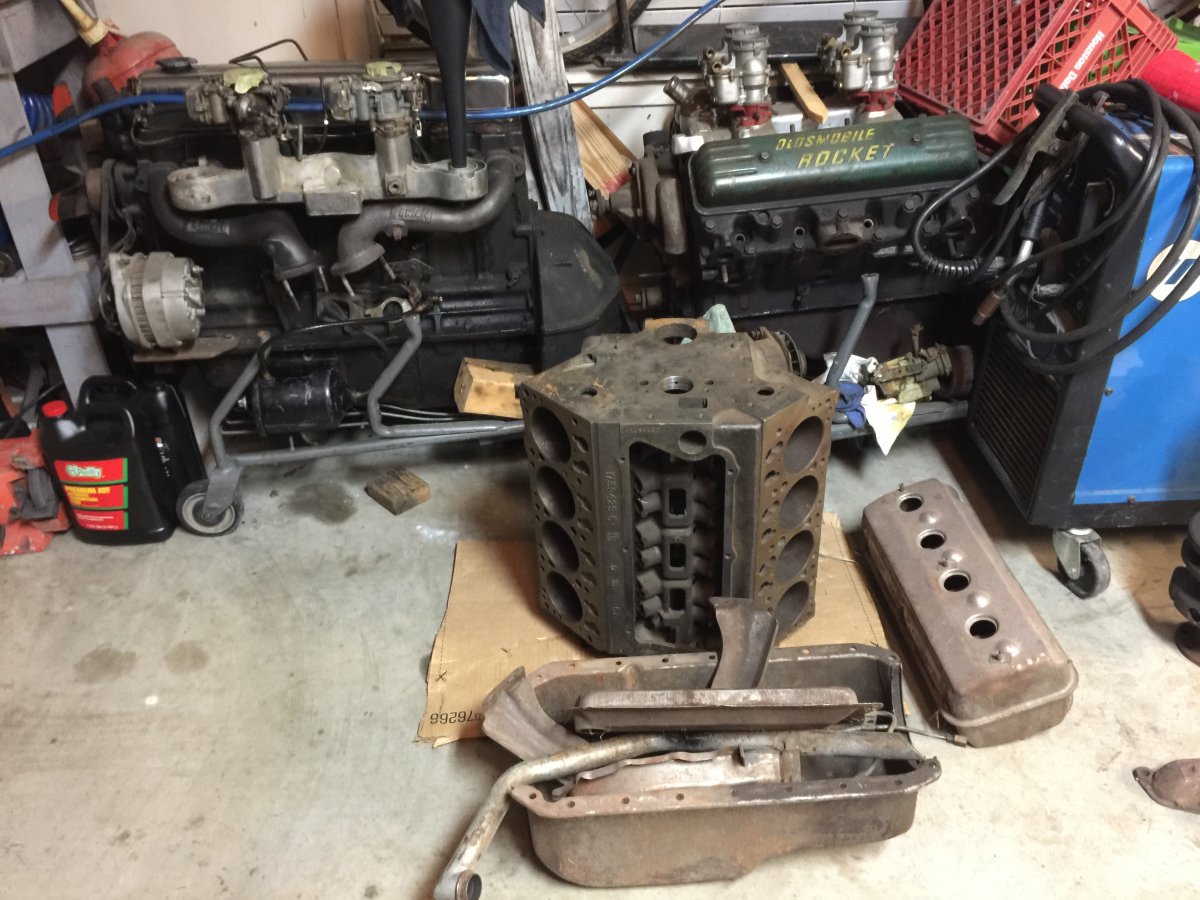

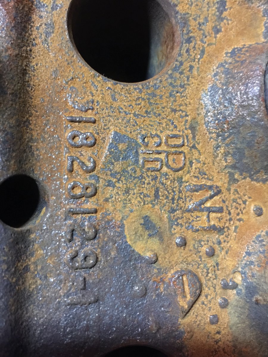

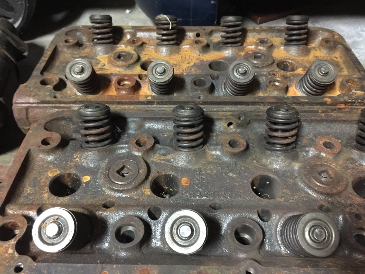

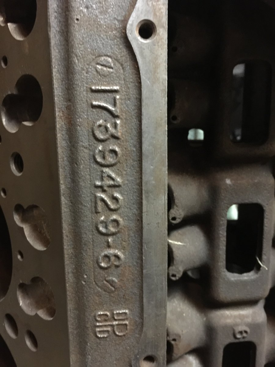

    5C2B95C6-4323-4468-B5D4-A4A92DF27117.jpeg B7BB48D0-080B-490F-9BE0-E64E49DE0314.jpeg A7D99C7F-6CB9-4AB0-90FE-B2B64F7FBBE0.jpeg I just picked up my first baby Hemi from a friend. I know it came out of a big Dodge truck, but some of the numbers are conflicting. It’s either a 57 325 or a 58 315. The number stamped in the block says it’s a 58 317. The number cast into the block next to the valley says it’s a 57 325. The numbers cast into the heads say 58 315. How can I tell for sure? Thanks in advance.

    Trucks did not use 325 engines.....largest in Dodge based were 315. The
    L8D5 engine code is a truck version. Casting numbers can be deceptive as the same base casting was sometimes used with differing bore and/or stroke for particular versions.

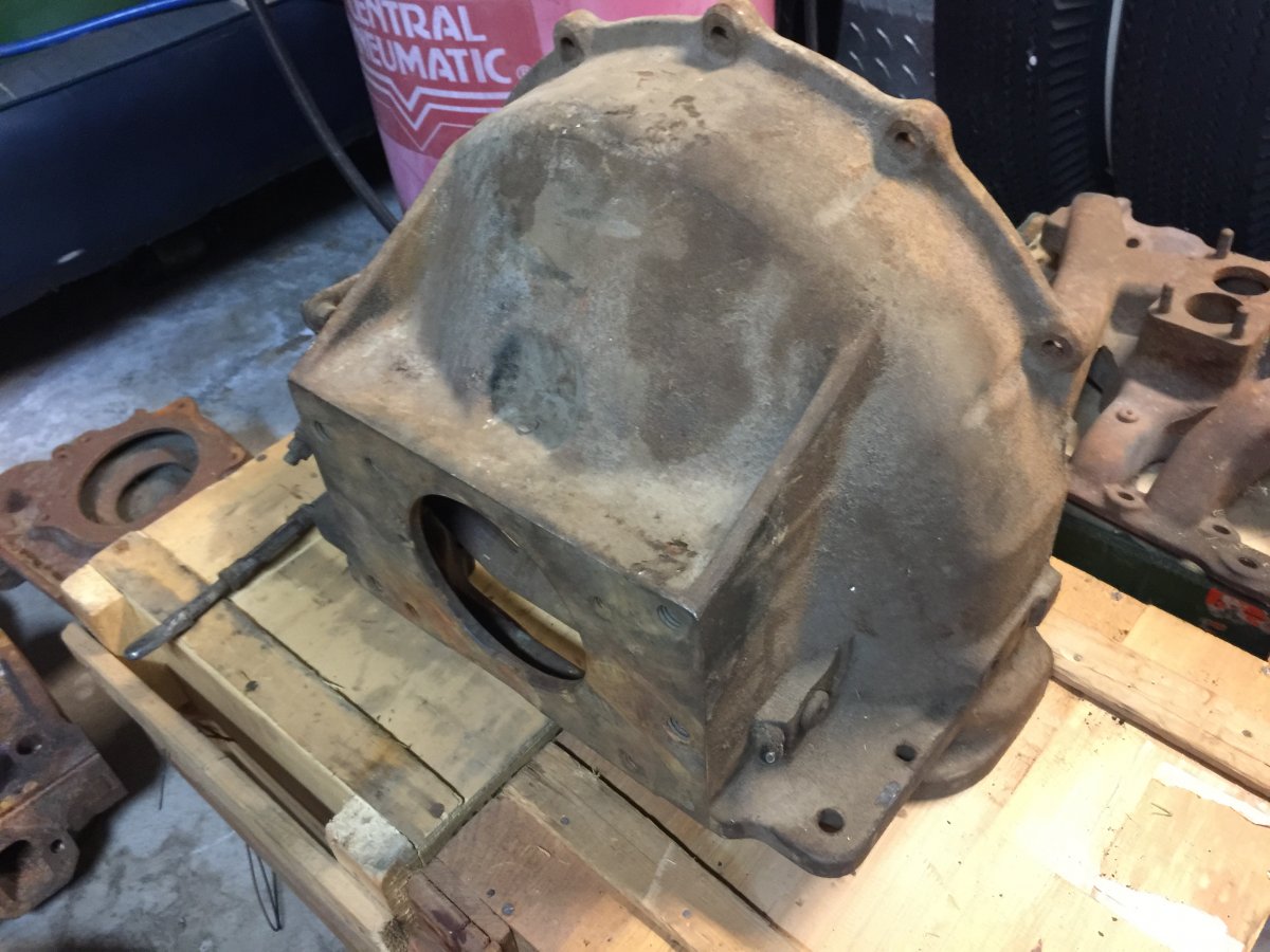

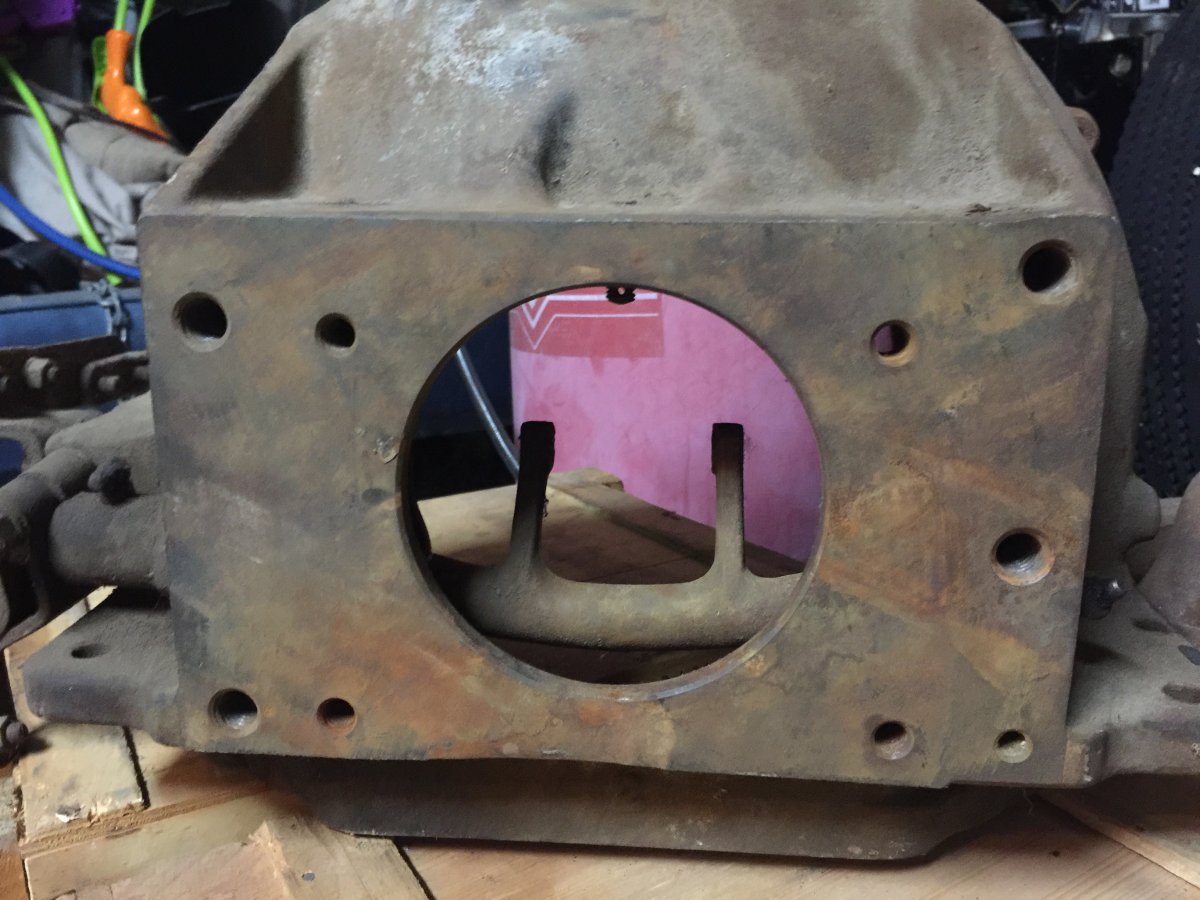

    1D0635D6-71D8-4F7E-A2C1-0F4C13F32644.jpeg Thanks! Well then it looks like I have a 1958 315. Another question. What manual trans will bolt up to the stock bel housing? I’m thinking about running an A833 4 speed behind it. It’s all going in a 48 Ford F1 Shop Truck project.

    take the picture of the bellhousing from the back, so we can see the transmission bolt pattern more clearly?

    0179AA0D-B7B6-452F-8BA1-CB725C8F1992.jpeg 6069B220-F75E-4ECA-B95A-FB2C00099C9E.jpeg Here you go.

    That particular bellhousing is an easy adapt for the A-833.
    Kerry, among others on this site, have made their own adapter in there own shop...here is a pic of Kerry's piece that he posted on an earlier thread:
    Keep your plate thin enough so that the bearing retainer can still register in the bellhousing. You might have to modify the hole diameter.
    If you have the time/energy you could also pile up some weld material/brass and make new bosses for the trans mounting bolts on the top. Without the plate like Kerry's you would then need 'something' for the bottom bolts...I have seen where a piece of common angle iron was bolted to the bottom of the bell.
