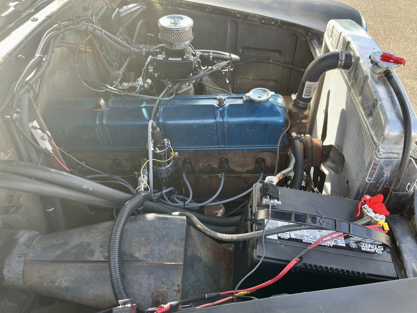

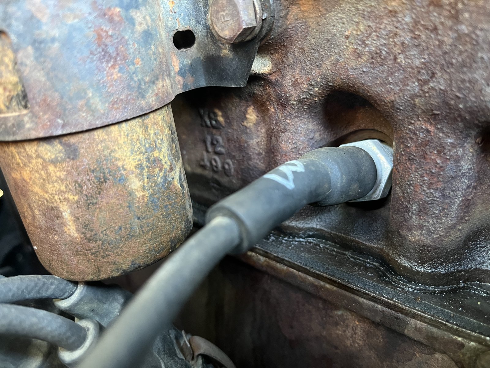

  1. I recently picked up a 1951 Fleetline that developed an engine knock over the weekend and I’m trying to figure out if it might have the original engine in it to decide whether I want to rebuild it or do a swap. The most comprehensive list of engine numbers I can find is from here: https://chevy.oldcarmanualproject.com/models/engine.htm#51eng, but it doesn’t have much on 235s from 1951, and the only markings that start with X (image below) are from ‘56 and should come with additional letters.
    If it looks like this could be the original engine, I’m thinking it would make the most sense to rebuild it; but if not, any advice on what to swap it with is more than welcome (maybe a 350?)!

    Did you look at numbers for 216’s?
    A pic of the engine would help to differentiate between a 235 and 216, the 235’s I had used 4 perimeter valve cover bolts, the 216’s I’ve seen had 3? Maybe bolts in the top and centered down the valve cover.

    yup we need a picture of the whole engine. It looks to me though by the one weird pic you posted that you hace a 235. the 216s had a side cover that went up over the spark plugs and 235s the side cover stopped at the head. a 70 year old car has probably had some stuff swapped over the years

    The 499 on the cylinder head would be correct for a '51 235. Of course, 235s only came in Powerglide cars at that point.

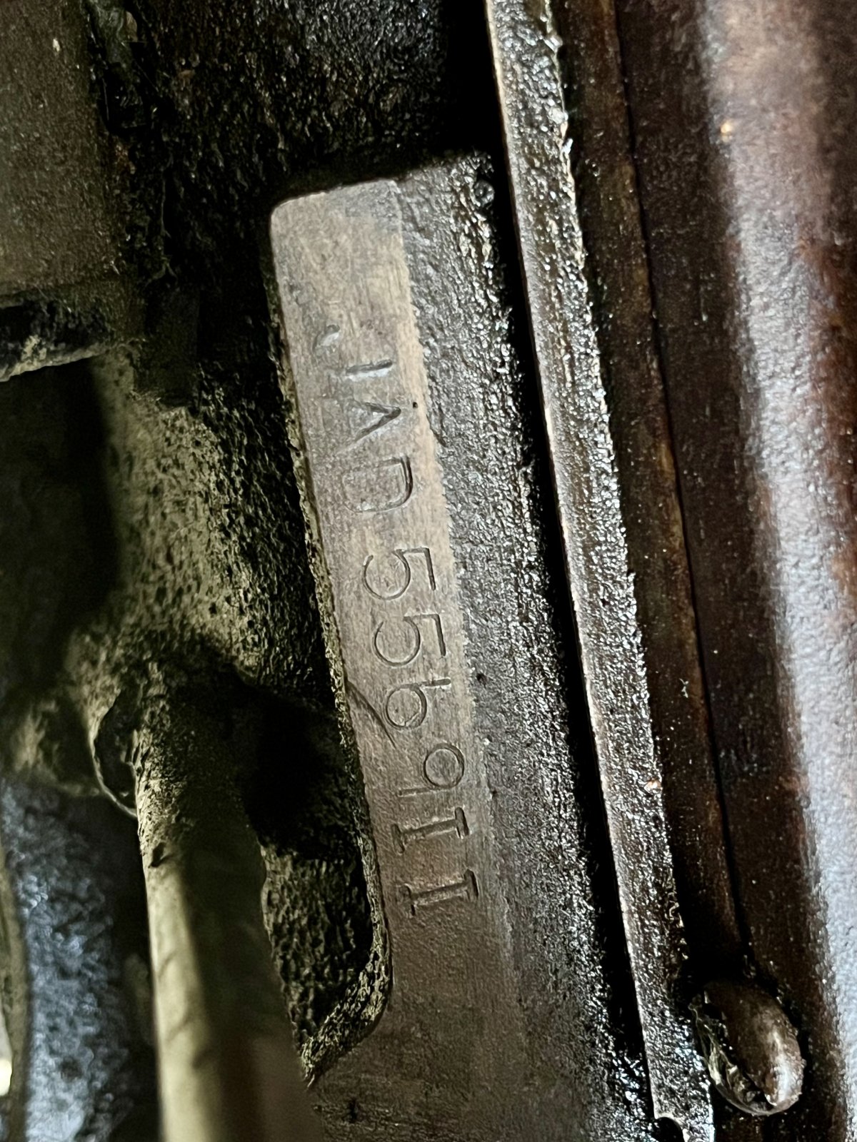

    you need to move the camera down just a bit, and maybe to the rear....there is a machined pad at the base of the distributor, which has the engine number stamped in it. Also, a bit further back, partly obscured by the starter motor, you should be able to find the block casting number and casting date code.
    If you find them, we can help figure out more completely what engine you have. The head casting number does make it look like it could be an original Powerglide equipped engine...let us know what transmission it has, also.

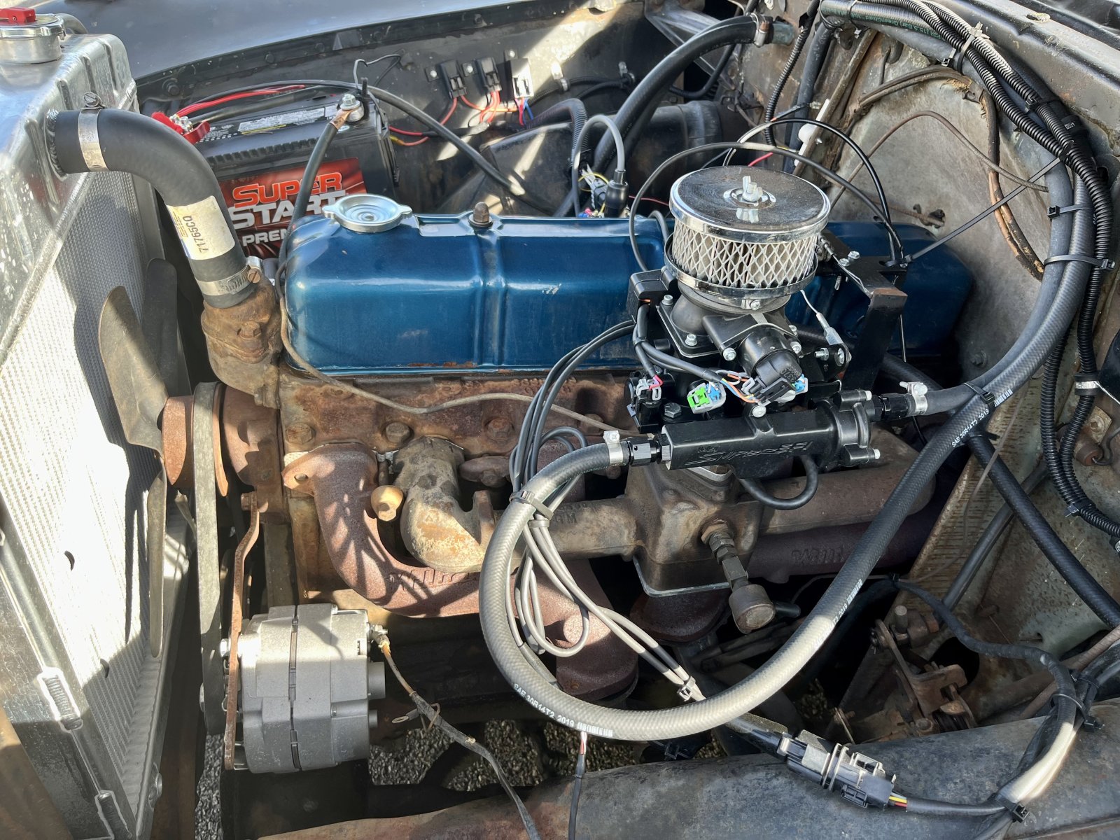

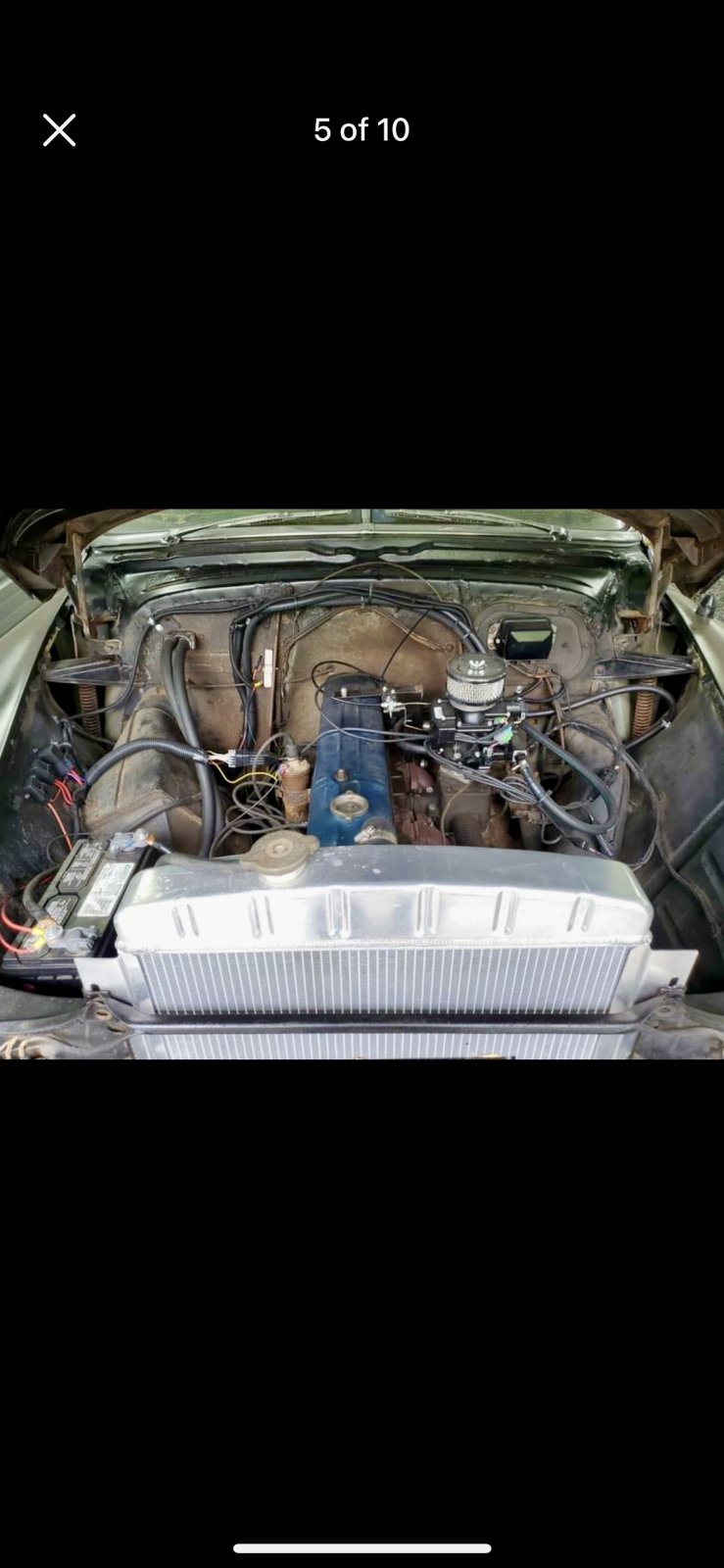

  7. Thanks so much everyone, this is all very helpful. It has a power glide transmission, I’ve included two pictures I have from the front and I’ll try to get more as soon as I can. The weird picture above is the casting stamp from the p***enger side center, I’ll see what else I can locate.

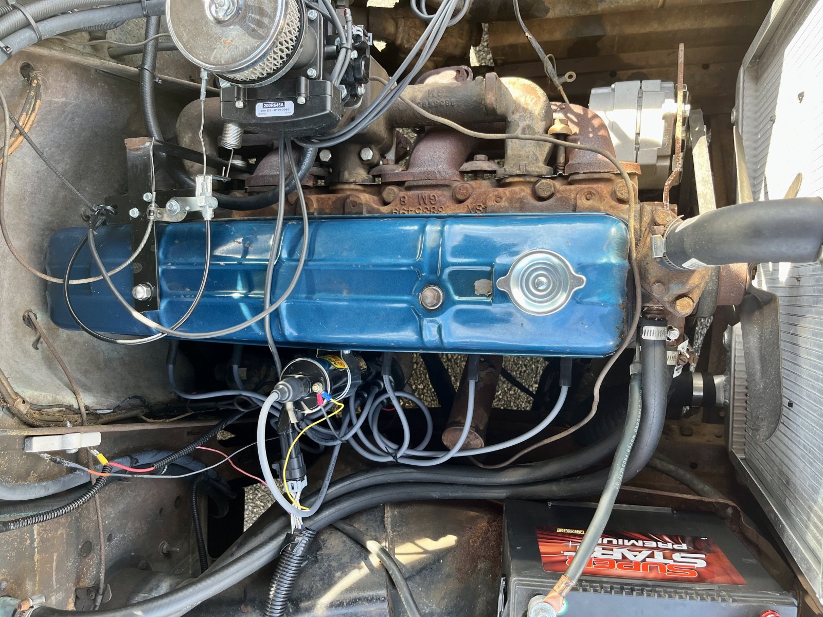

  9. Here are some better pictures of the engine and the actual engine code (thanks for the help confirming I didn’t have the right number), it just took a bit of s****ing and cleaning to find. This looks a lot more like what I expected to see from an original engine!

    J is 51, A is p***enger car, D is 235 (for powerglide), as best I can tell.
    The casting date, hiding on the block near the starter, should confirm the year. And the casting number (and the partial side cover) should confirm the displacement.
