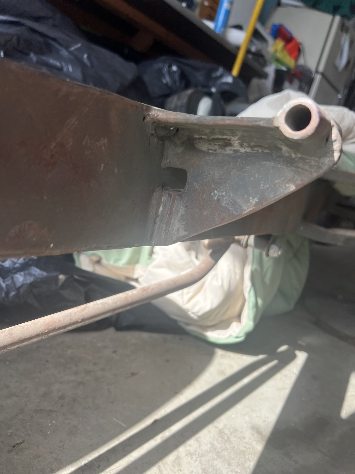

    Going to sound like a total idiot here but can anyone help me identify these funky motor mounts in my deuce frame. They were there when I got it. Previous owner p***ed away so I can’t ask him. I’m thinking if they are sbc are they missing something? Any help would be greatly appreciated
    Mike

    They look like they would accept the factory rubber mounts for a SBC or BBC.

    Agree with Fordors..

    Ahhh ! You guys are great. Sorry I just wasn’t wrapping my head around it but after looking at that pic it makes more sense to me now. Thank you

    If they are for a Chevy, it looks to me that they are missing the square pad for the motor mount to rest on. Without the pad, all the load is on the bolt. 60 Special

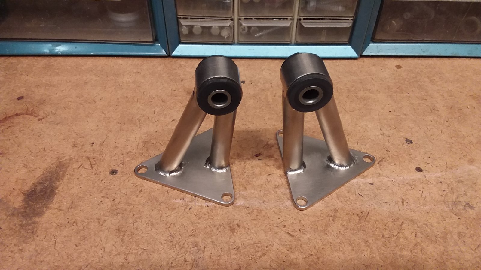

  6. There are two types of mounts. The width of the tube will determine it, one is narrower (tube size) and taller (mount face to block) and one is wider and shorter.
    In_The_Pink and Bob Lowry like this.

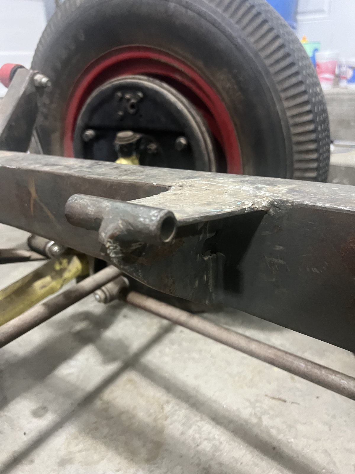

    Thought I would throw in another curve ball, possibly small block Ford ?

    Ford or Chev, should still have the support pad. Doesn't take much to do it properly.

    I’m leaning toward early SBF. Here’s a better pic. They may be the Pete and jakes mounts

    They appear to be directly across on each side of the frame, in about the position where a SBC would fit. I think SBF are not directly across from each other?
  16. X38
    Joined: Feb 27, 2005
    Posts: 17,498
    X38
    They are directly across from each other, but the factory mounts have an offset.

    Look very much like my TCI frame and mounts. So do the shock mounts
