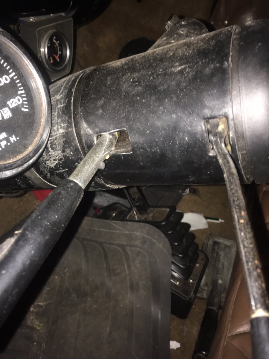

    I just purchased a 1930 Model A. I am trying to identify all components of the car for future reference. I have no info from the previous owner on many components.
    It has a steering column that I need help determining what it is. It has tilt and cruise. The cruise does not work. And I dont care about the cruise. I do want to do want to know what the column is.
    Any help would be great.

    Gm probably around 1976.

    I'd guess 69-76ish. GM for sure, If we could see the whole thing, then it might be easier to ID.

  5. its 70's GM style column with that cruise switch

    Is there a shift indicator on the top? May be an AMC column, Mostly a GM column with a few changes.
  7. Here is the one out of my 76 Buick century
    late 60's style had a crescent moon style connector, I do believe about 73 GM went to the flat style connector like yours..
  8. Kind of odd to see the cruise on the tilt lever though......

    That cruise switch is NOT factory, it's a Perfect Circle add on unit.

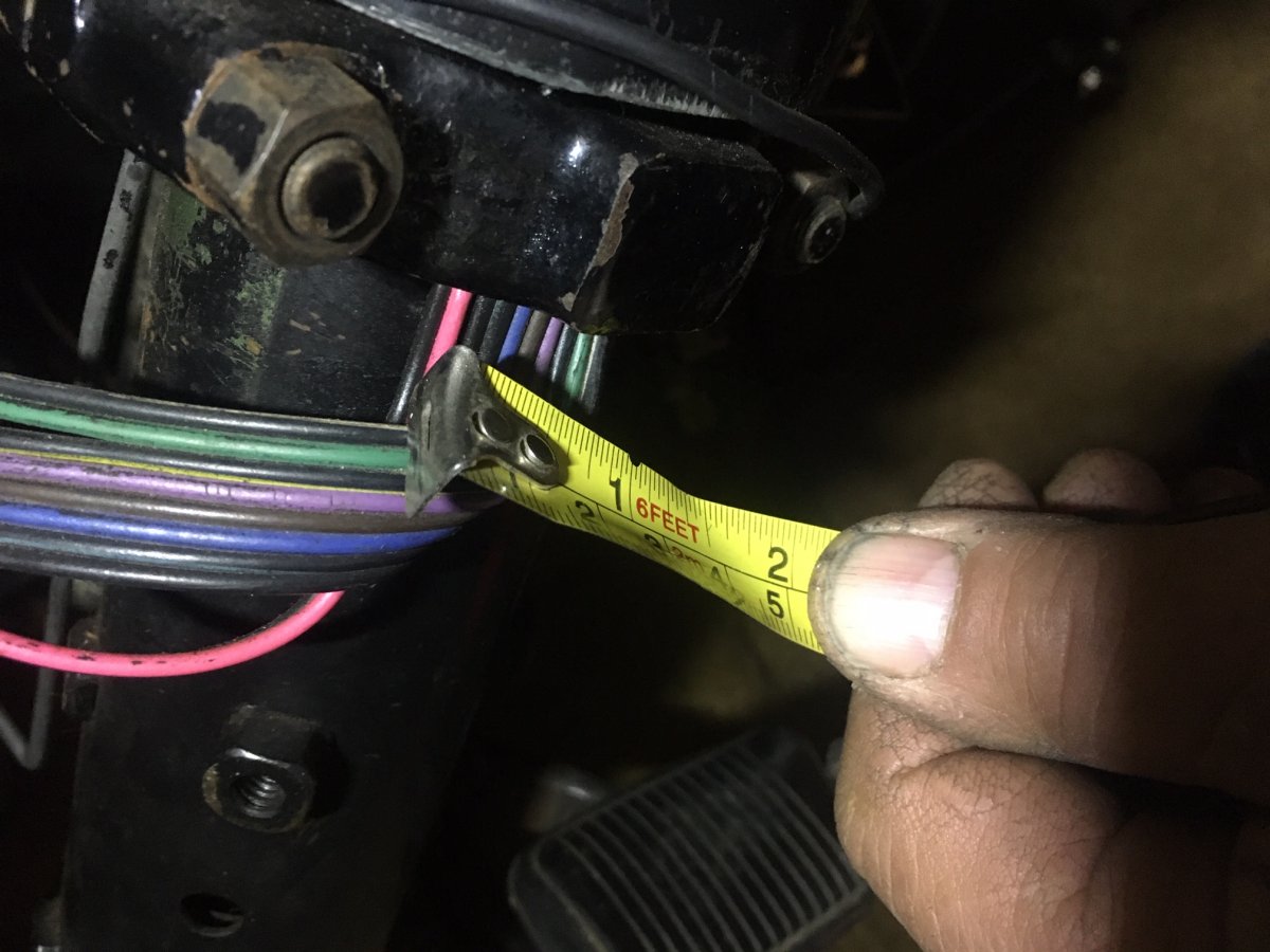

    It’s a GM column. Measure the distance between the prongs of the wiring harness connector bracket. That’ll tell you whether it’s older or newer.

  28. Ben Chirco
    Joined: Oct 21, 2019
    Posts: 240
    Ben Chirco
    Thanks again for the help.
    I did not know that "AMC, IHC, and Chrysler use the same parts in their tilt columns of this era".
    Also, i am attaching a picture of what i think David Gersic meant by "Measure the distance between the prongs of the wiring harness connector bracket" . These pictures with the tape measure on them are taken of the column harness. Maybe that can help. Thanks again.
  29. squirrel
    Joined: Sep 23, 2004
    Posts: 60,014
    squirrel
    The bracket is the metal part that's spot welded to the column, that that plastic connector fits into. But measuring the width of the plastic connector tells you the same thing, eh?
    ***ume the column is from a 1973 Camaro, and buy your parts.
    David Gersic and 427 sleeper like this.
