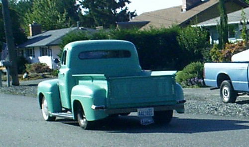

    I never post, but since this topic is near and dear to me - Flipped rear over stock springs, c-notch and new shocks...dumped the rear pretty damn low, I s****e on the driveway (any driveway) and the ride is kinda stiff - but I like it. Just my 2cents.

    Yeah, it's low - Funny thing, when you look at the enlarged pic you can see how my tailpipes are flattening out from dragging on my driveway when backing out.

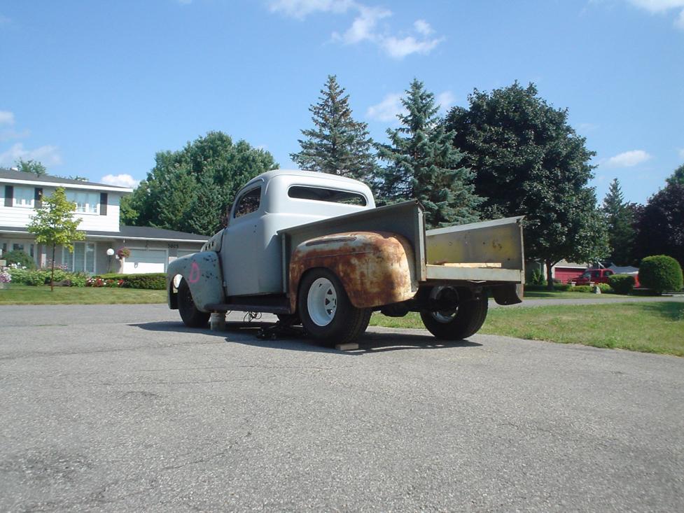

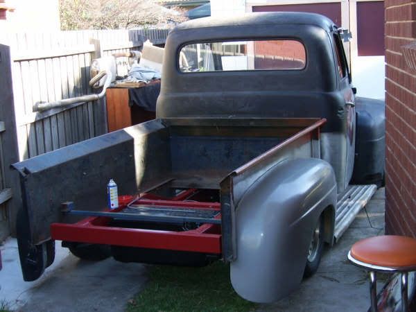

    I used an 8" out of a Fairlane flipped on top of the springs and removed a few springs and did a little C notch. I have a plywood bed in it right now so I just welded in a few pieces of 2" angle iron 2" inches above where the old bed would be and put in 2X2 tubing under the 2 stock bed supports and layed the plywood right on top. Works good, as I have hauled motors, s**** iron and wood ect. with this old beater.

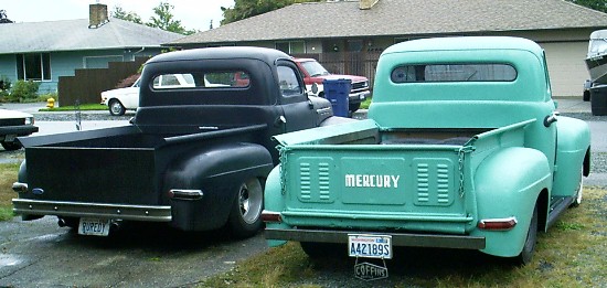

  12. k-member, how much of a chop did you take out of those? Looks good.
  13. k-member
    Joined: May 25, 2002
    Posts: 2,114
    k-member
    Both have TCI total cost involved MII front ends and are both chopped 4 and 4.5 inches. OldBeets black one has 390 FE with tri-power & all the goodies and my green Merc has 289.

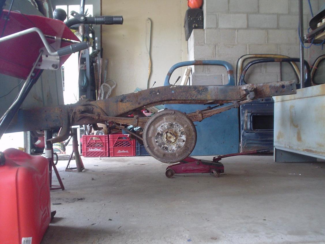

    I bought a kit from ch***is engineering inc but I don't have everything fully put together yet.
    For one. The springs mounts are underneath the frame now instead of on the side, so it's possible to put a bigger tire in (I have to do a couple inch tub for clearance in my case). The mount on the side make it different to lower it. With the axle on top of the springs it's still pretty high. I think I'm going to try some lowering blocks and see how it looks.
    For reference my rear tires are 285/70/15 (so 31 inches high and 12.1 across) and the rear end is a Ford 9 inch. The box was from a friend and in pretty rough shape, so I'm not sure how off anything is. I plan on dropping the rear end 3 inches from where it is now, and the front end should drop 1-2 inches with motor and real springs.

    I did nothing more then remove most of the leafs, otherwise the rear end is stock. Upside is the truck rides really nice and has a nice rake, downside is you can't haul more then a couple hundred pounds without bottoming out.
