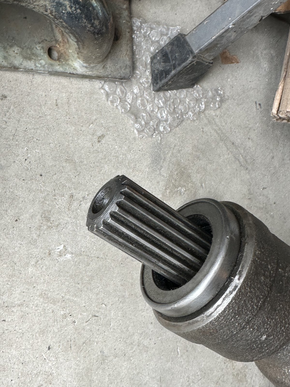

  20. 51 mercules
    Joined: Nov 29, 2008
    Posts: 4,318
    51 mercules
    Just went through that. I tried a powrglide one that fit but would of needed to be trimmed way down. The I got lucky and found this one on the HAMB. This what you need to find. . 50 olds.JPG 50olds1.JPG
  21. Peter Bowman
    Joined: Oct 27, 2020
    Posts: 32
    Peter Bowman
    Here's the measurements I got:
    1.169 major
    .985 minor
    I need 16 spline, angled splines. The Spicer stuff is all square spline.
  22. BJR

    As @RDR ssaid, I used a Ford pickup sliding yoke that fit the splines well and had the drive line shop where I bought it make the drive shaft and turn the OD of the yoke down to fit my LaSalle trans. They left the yoke long so I could cut it to the length I needed. Seems to work well.
    It's in my '33 Plymouth with 331 Hemi build listed below.
    Dave
  27. RDR
    Joined: May 30, 2009
    Posts: 1,544
    RDR
    "What we got here is a Failure to Communicate".....
    I now realize that there are 2 different tail shaft sizes..
    The LaSalle trans shaft is 16 spline; 1.375 Dia. as in Daves' 33
    The 50 Olds shaft is .........16 spline; 1.172 Dia. as has been said
    and they both have involute splines..
    vtwhead, the 506414 early yoke looks correct. A bit funky with the straps but should work
    if you haven't got it or it is still available...get it.
    dwollam likes this.
