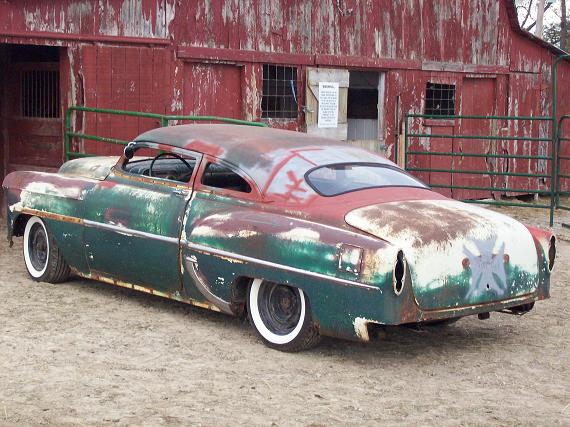

    i been contemplating chopping my 53. i think they look pretty darn good unchopped, but the more i look at the roof, the more bulky the crown starts to look. i do like the curved glass in the back. rodders journal did an article on a barris chopped 52-54 merc with some pics of the chop in progress. i'll try to dig it up and scan the photos. here is a pic of a pretty nice chop. maybe a little extreme for me, but looks good slammed. anyone have any more pics of this car?

    I'm with you. I have a '53 Mainline and I have yet to see one that made me say, "Thats it, I got to chop mine." There is something about the roofline itself, too bulky above the drip rail or something. And everyone I have seen chopped just dont have the flow like a 49-51 has. But I do have to say that the black and green one is the best example I have see to date. And I have heard that about the roof being a chevy.

    That is why i'm trying to do it right, if there is a right way. The black and green car looks good to me, but i do want to keep the post.
