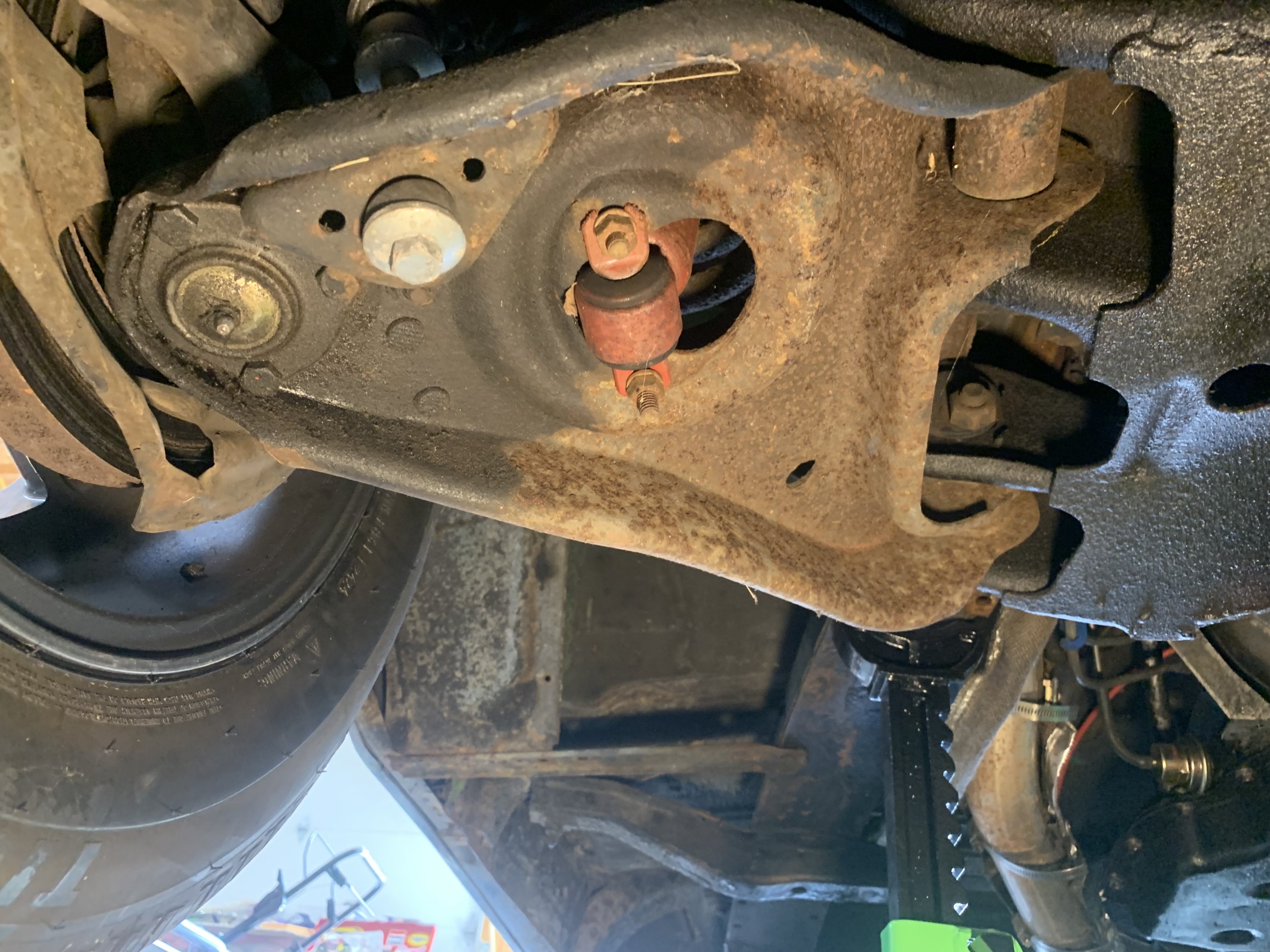

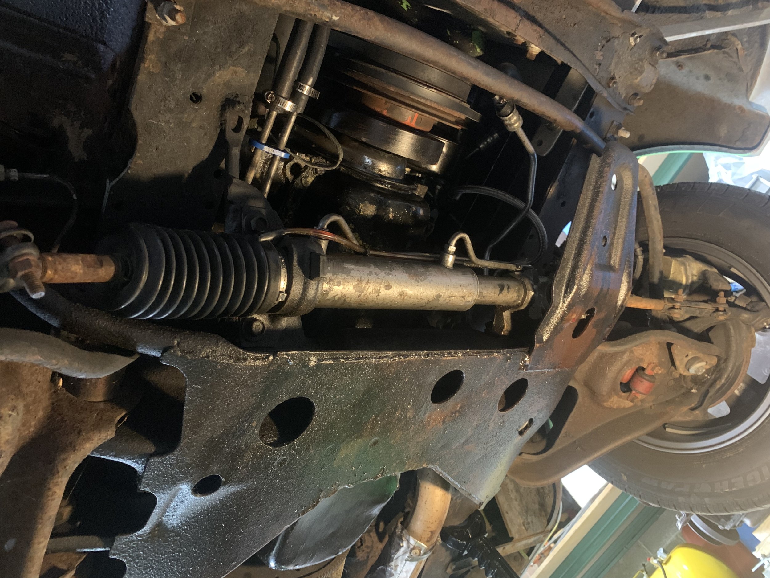

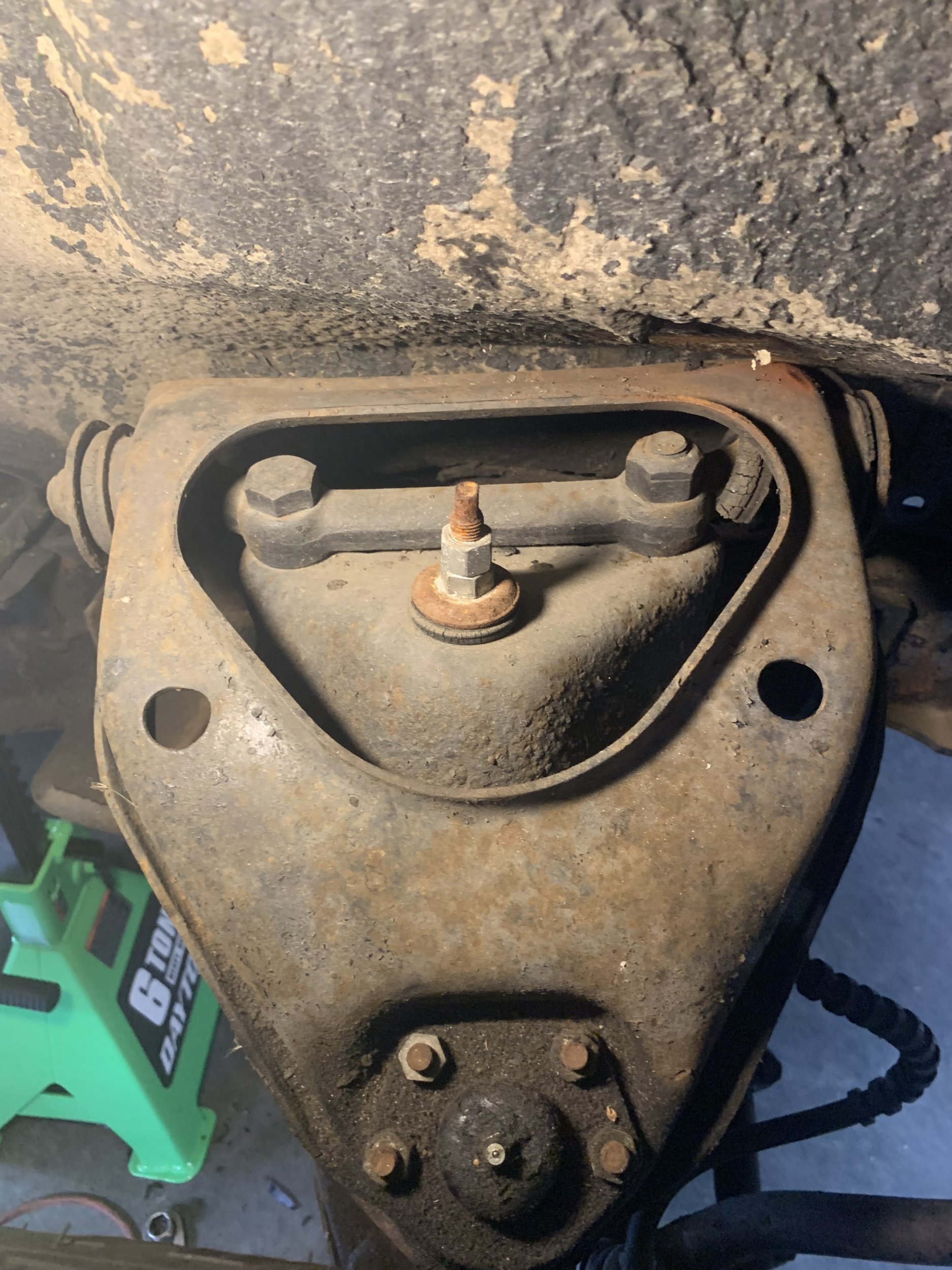

    I have a ‘53 Chevy 210 sedan that has had some upgrades done, ‘77 350 w/tbi heads, TH400, 9” Ford rear end. Has a front crossmember grafted into the frame with R&P steering. One upper bushing is bad, need to figure out what is here. Here is a pic of the RH upper control arm. Thanks!

    looks like you got a Pacer front end. More pictures of the whole thing might help confirm.

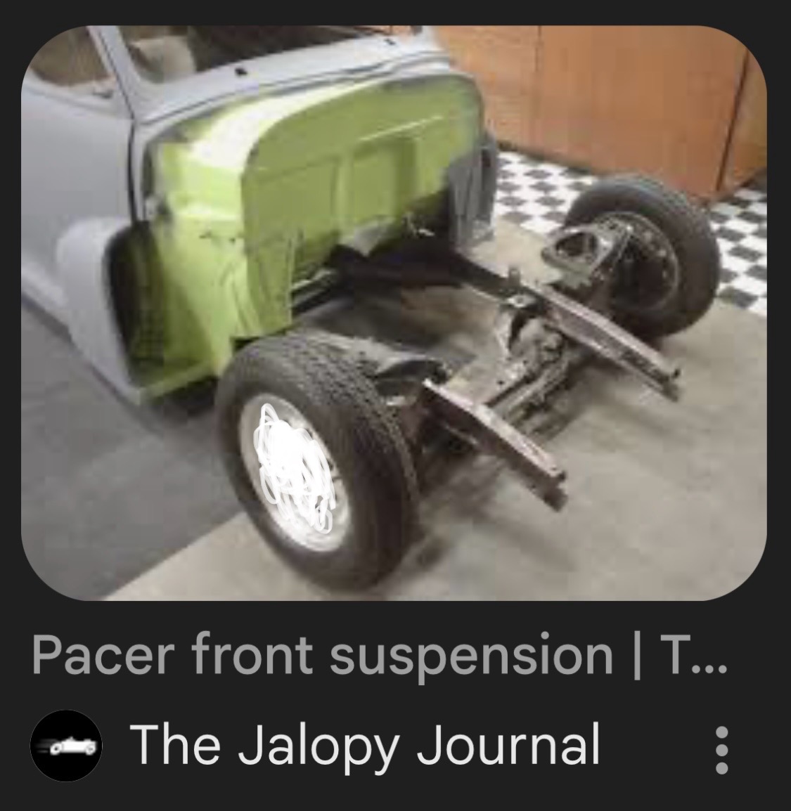

    I guess more common than I thought! Looks like that’s what was grafted in! I’d never have figured it out without asking here. Thanks guys!

    In the later 80s Pacers were really cheap, no one wanted them, and turns out it's a good fit in lots of cars and trucks. Now that they're almost 50 years old, not so good of an idea in hindsight.
