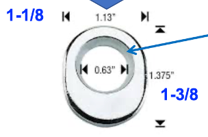

    I really need to find a supplier for 10 wheel lugs and 10 ET-style washers for my VINTAGE Torq-Thrust (look like) aluminum wheels
    The washers look like this and have a tapered seat BUT my application requires that the hole for the wheel stud is centered (not offset as shown in the pic). This enables the wheel to fit a Chevy bolt circle. The wheel studs are 7/16-20

    ET used either the A or the B washers which gave the option of either a bolt pattern of 4 1/2" or 4 3/4".
    Can't remember which is which now though.

    There is one washer with the offset lug hole its for 4 1/2" with the hole towards the center, or flipped with hole towards outside for 5"lug patterns. The washer with the lug hole dead center is for GM 4 3/4" patterns..
