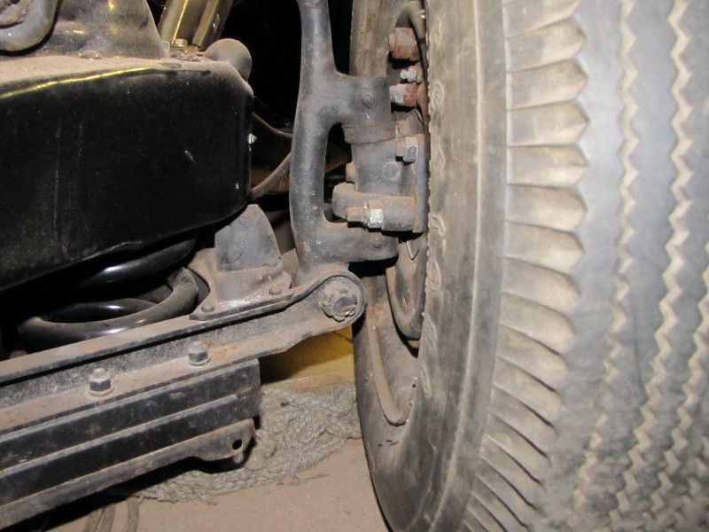

    I have a very big problem with the lowered spindles, I installed in my 1950 Shoebox Coupe.
    If it’s important: it was a 6 Cylinder Car. Now it’s got a 302 Ford with C4.
    The spindles are Jamco.
    I’ve got 15 x 5 inch Ford steel wheels on the car. Took them from a 1966 Galaxy.
    The space between the lower control arm / A-Arm and the inner rim is so close, that the lower A-Arm end is touching the rim, when I drive a curve.
    I realized it very fast, because after the very first drive with the car, the lower A-Arm shaved off all the balance weights from the rim. You can’t imagine that sound, when they bombed into the inner fender.
    After checking that, I found the scratches inside the rims, on the fresh powder coated wheels.
    Have I done something wrong by installation?? Parts were lying around for over 2 years, before assembling.
    Is this a thing that happened only to me? Or is here anybody, who had the same problem?
    It would be nice, if you could check the pics, perhaps to see, what’s wrong, or what I can do.
    Thank you
    [​IMG][/URL
    [​IMG][/URL

    Seems like you need rims with different ET.
  3. Install a 1/4" spacer between the wheel and the drum. Or get wheels with less backspacing.

    But is it normal, that the lower arm is so close to the wheel???
    I tried 3 pairs of wheels. All steel wheels, original Ford, from the 50s and 60s. i never thought, they could be wrong, for a lowered Shoebox.

  6. No, it's not 'normal', but many times when you change one component you find that something else now doesn't fit. I had exactly the same problem on a car I owned (with aftermarket control arms), spacers fixed it.

    The problem with your reasoning is, all the wheels were designed by Ford to work on their UNALTERED vehicles.
    As Crazy Steve recommends, a shallow wheel spacer would be the easiest and least expensive fix. It won't take much change to gain the clearance you need.
    16" wheels (late Crown Vic, for example) would also do it, but that means spending a lot of dough.

    I tried spacer, but the wheel bolts are to short and very firmly connected to the drum. I was afraid, to destroi the drum. So I realy wanted to know, how this looks on other Shoeboxes.
    I still own the original 16# wheels, but I realy wanted him on 15#. And now, that I bought a brand new Set of the 15# tires.....
    Do you have a tip for changing the bolts, without bending the drums?
  9. Changing wheel studs on drums is normally done on a press with a support under the flange to the press table. Never beat them out!

    I don't know much about dropped spindles, but yours seem to have a wicked bend in them that sucks the wheel inboard. They look a lot different from others I've seen.
    You could shave the outer edges of the LCA and gain some space.

    Are you sure you have the dropped spindles on the correct side? Does it aline correctly?
  14. Grease fittings go to the front. Switch sides and you can't get to the lower fitting due to steering arm. I have the same issue on my 57 Ford with there spindles. It's just a wheel thing. Make a different choice.

    have you contacted JAMCO for info as what to do? spacer/new studs sounds like relative easy resolve. if you do have studs replaced be sure to replace wheel bearings - sometimes the heat caused in removal of studs will damage bearing race.
  16. ^^^ yep
    Another option is stick on weights like they use on aluminum wheels. But if it were me I would use steve's advice on this one.

    I think its because of your wheels doesnt have correct ET.The current lowering kit on my car is 2 squaretubes bolted on lower A-arms.Our vehicle inspectors love things like that...
    Anyway,i have drop uprights and unmolested A-arms waiting for assembly.So,dont care about the lowering method in this pic,but compare the wheel ET's.That how it looks like with OEM shoebox wheel:
    And that was with 15" rim,i know that there was 16" wheels on shoeboxes too.But if i remember right they were only in 1949 and models with 6 cylinder engines..

    It looks like your dropped spindles are narrower than the spindles in the last pic...i/e from the pics, appears that the KP boss in the dropped spindle is over the top of the lower control arm, on the next spindle pic by Finnrodder, it is clearly off of/away from, the control arm.

  20. Some food for thought. I was looking for one to post a photo of for ya but no luck. I'll try to describe it. Newer custom wheels are using a different style lug nut. If you can get by with a 1/4" or so spacer they just might do the job without changing studs. What I'm talking about is instead of the old style long strait shank nuts and compression washers they have gone to a tapper seat like our standard steel nuts but with a short section of strait shank on the open end. If the shank section will pass through your steel wheel hole, seat the tapper against the wheel counter sink and not bottom out against the hub while passing into the spacer I think you'd be home free. I'd certainly try that long before I'd go changing studs just to find I now had a fender to tire issue.
