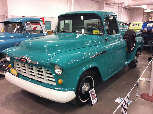

  25. e-tek
    Joined: Dec 19, 2007
    Posts: 424
    e-tek
    from SK, Canada
    Thought I'd update a few of my threads!
    This beauty got all finished up - runs fine now and is going to it's owners home this week. BTW - oldcarfart had it partially right, as well as needing about 2 gallons in the freshly cleaned tank to cover the pickup tube and get the fuel flowing!

  28. e-tek
    Posts: 424
    e-tek
    from SK, Canada
    And off she went:
    I remember when it showed up:
  29. e-tek
    Posts: 424
    e-tek
    from SK, Canada
    When done the truck won 1st Place in cl*** at the Draggins Custom Car and Rod Show:
