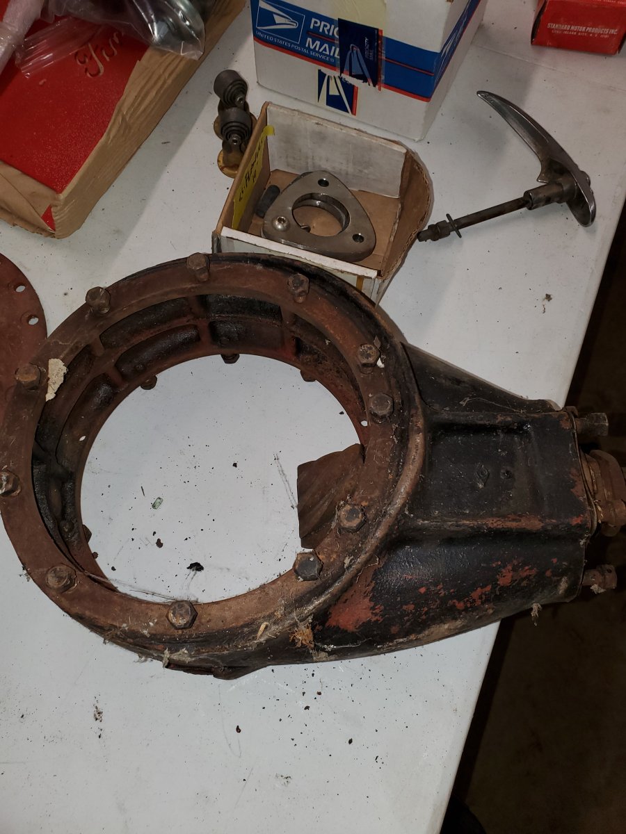

Technical Need help to ID this rear

    Only numbers are 86H 4025, any ideas?

    H is Lincoln, right? I'd guess late 30's to 48-ish Lincoln.

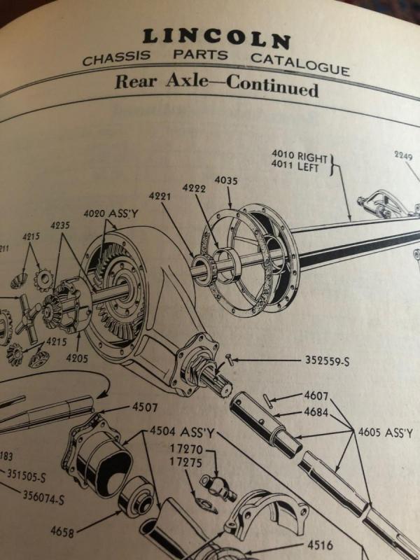

    IMG_0670.thumb.jpg.98005592c6ef71f61eae0188c8b04010.jpg 167731366_86H4020.thumb.JPG.a0197617a3e2ca8b4596b0d189757de7.JPG This might help you. 38-48 Lincoln. Are you interested in selling it?
