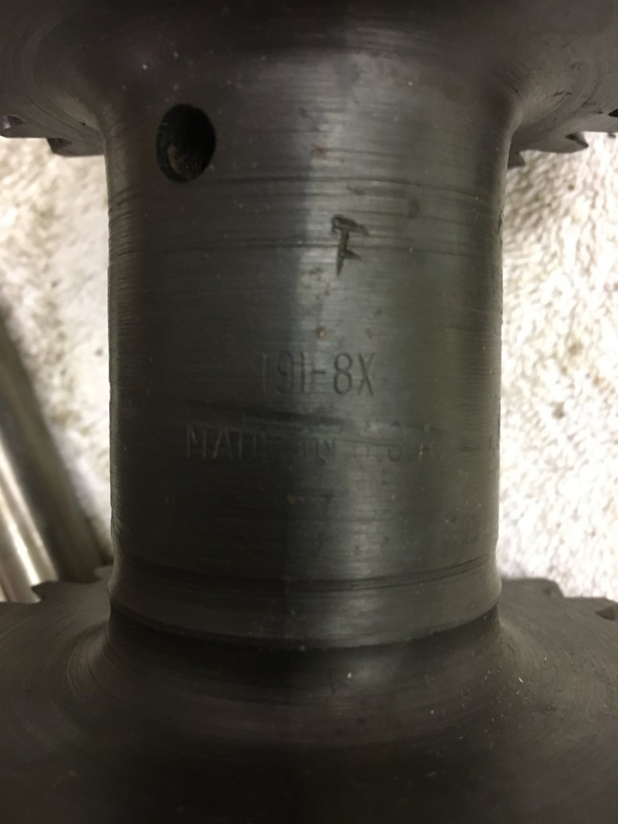

    F26708BE-59CC-4726-87ED-9E257A47B7C5.jpeg 1236DB5A-FCC1-4E6E-A978-0E190725F7BE.jpeg Mac,
    Thanks!
    Here is what I have:
    Cluster gear is marked with the 191-8X. It is a 26-24-18-14.
    Input gear has 18 teeth. It has a bearing surface OD of 1.57. The clutch spline diameter is 1.37. The gear diameter is 2.64. I think this is 40s Zephyr?
    2nd gear is Ford 22 teeth.
