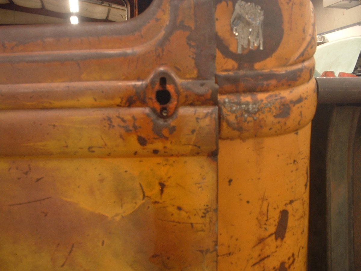

    Trying to get the doors swinging right on our '34 cab, they are a least an inch low at the B pillar. Have shimmed the body quite a bit under the A pillar and pried up on the bottom of the door as much as I feel comfortable but they keep drooping down. Any help? Thanks-

    It’s a very common problem that I’ve encountered with any 32-34’ cab I’ve done work to. A lot of times the sheet metal ear/flange in the bottom of the B pillar that is riveted to the subframe is torn or loose. This plays a large part in a cab “racking”. I’ve had instances so bad that I made a sturdy tripod and tacked it to the subframe and took a porta power off of the top to a board that spans between the top of the A pillars and pushed it till things lined up.

    Well I've re-visited how we shimmed the A pillars and it looked like we could go some more so I built a spacer for the drivers side and it fit great. The shim ended up being about 1 3/16" tall, every thing looked good. Went to the p***. side and had to make a spacer about a 1 7/8" tall and the door fit good. Problem is now there is a noticeable list towards the drivers side and the whole cab is up in the front and running down hill towards the back. Glad I can get the doors to fit but now need to figure out where the twist/bend, whatever is coming from. This is a channeled cab on a custom rect. tube frame. Thanks for the ideas so far, I will keep plugging away at it!
