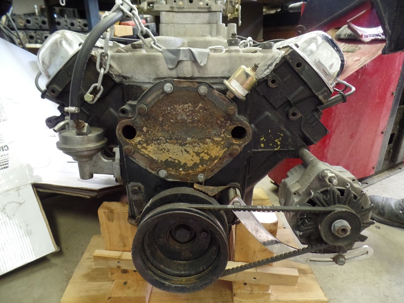

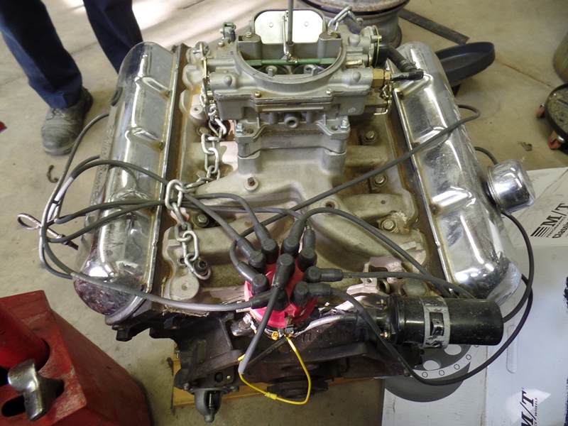

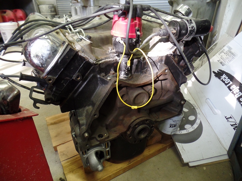

    We don't know what year your 455 is. How about two more pics...
    show the distributor cap, then we know if it's points dist, or if HEI dist.
    show the back/side of alternator to show where the plug-in terminals are. That tells if it is a built in regulator, or if it needs an external regulator.
    Also, there were two different Auto transmissions used in 1956 Olds. The base model 88 had a shifter with NO park position. That one would need some modding to work with a TH400 or whatever you have on the 455. The 1956 Super-88 and 98 had a shifter that has Park, that would be easier than the other.
  6. this is the 455..it was in a boat for 3 months which brings up another question i know on boat motors they useally have adifferent cam...is there any way to tell if it had one put in it without tearing it all apart? and as of looks i will need a water pump a flex plate a power steering pump fan blade and a adapter for when i mount the 700 r4 trans...anything else im missing? and without being where its at at my father inlaws in vegas i cant look at the code..im pretty sure its a 72

    It looks like the heads are G heads from what I can see in the pics, which if they are original to the block would make it a 1971 engine.
  9. i know one is a g but the other is another letter... i dont know which one being im not down there... so somewhere in its life on head got switched out

    At least you're keeping the car ALL Olds!!! A 1956 442! It looks like you have a Mallory, POINTS style distributor, and probably an older alternator, as opposed to an internally regulated one. Do an E-Bay search for "Engine Swapping"; there are several books about what is involved with engine swaps. It'll help you out with motor mounts/mounting, electrical, etc. The issue of swapping a "boat engine" is that sometimes boat engines are reverse rotation. Camshaft, starter, and those sorts of things would need to be changed out, but I don't think your engine is reverse rotation. Keep us all posted on your project. I am Butch/56sedandelivery.

    Mismatched Olds heads will work together but be aware the "J" head, also known as the smog head, has smaller valves than all the others so doesn't flow as well. Avoid if possible
  15. thanks everyone for the info...gumbler i do know the other one is not a j head because when i looked at it 6 months ago i remember it not being it just because i remember reading someone saying j stands for junk head..
  16. The ignition on the 455 is the same style as the 56 so you won't need to do anything but remove the small wire from the + side of the coil on the 56 engine and attach it to the + side of the 455's coil. In fact, you can re-use the 56's coil if you want to....either way as the 56's coil and the 455 coil should be the same thing.
    Starter wiring should be the same also.....just remove from the 56's starter and attach to the 455 starter the same way.
    The alternator wiring will be different if you use an alternator as the 56 Olds used a generator with a separate regulator. You'll have to let us know if you plan to use the 56s generator/regulator or an alternator and which alternator...photos will help. Plan to use the alternator in the photos?
