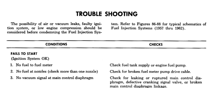

  9. Dan Timberlake
    Joined: Apr 28, 2010
    Posts: 1,583
    Dan Timberlake
    .From the rochester manual in post 4. specs go to 1962.
    elgringo71 likes this.
