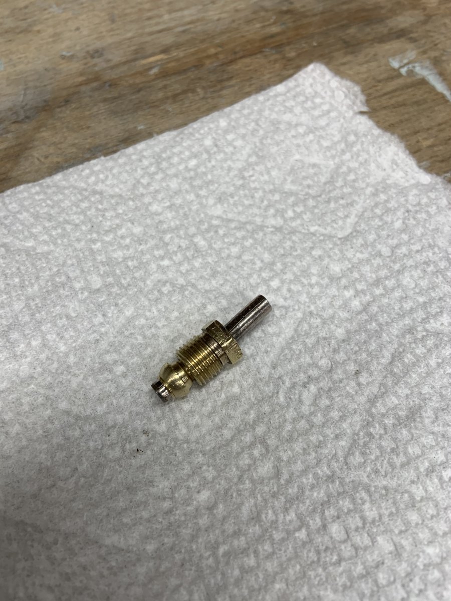

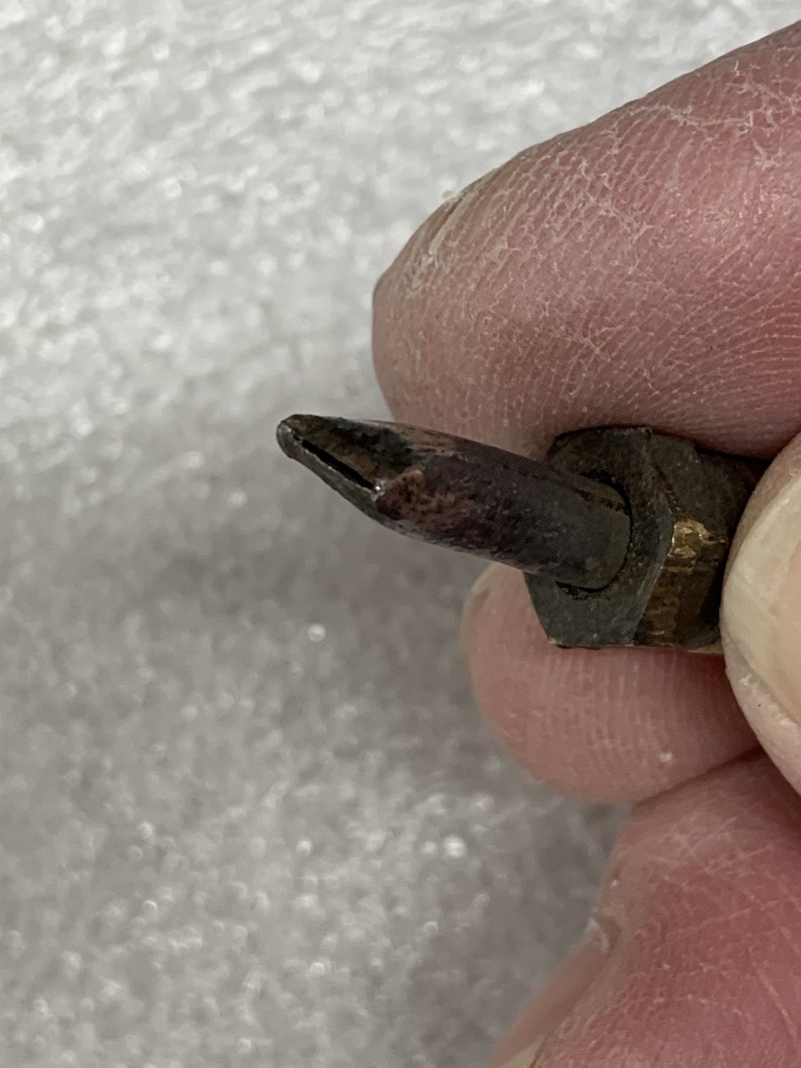

    96FBB2D9-CFF9-4B2A-AE1D-A36325DC0953.jpeg 2AA7109A-B91B-4D18-AD8D-7C6B1DF67015.jpeg 6FD50FA7-8D7B-4982-9D09-AA5F33EFC591.jpeg So I sent a 1933 gauge cluster to be rebuilt to a reputable person who has been recommended on H.A.M.B. The gauge in question is a mechanical oil pressure gauge. New internals but the case is original. Needed the fitting that goes into the rear of the gauge. Called the guy who did the work and he told me it’s special, he had one and send it. Got it in the mail today and the pics tell the story. It was bent more before the pic, I did my best to clean it up and straighten and open the tube. This tube needs to go to the oil sending hole on a sbc crate.
    So does anyone have this type of fitting with a longer tube to sell or someone I can be referred to ?
    Does anyone have any ideas on how to connect a 3/16” tube to this stub ? The hose is 3/16”
    Thanks in advance

  2. rusty valley
    Joined: Oct 25, 2014
    Posts: 4,378
    rusty valley
    looks similar to the ferrels used on big truck air lines. sort of cone shaped as opposed to the plain round that you can buy at a hardware store. you need to find a ferrel so you can then get rid of that beat up nut, which looks like a ford fuel line nut to me. if you really had to use it you could clean up that line, tin it, then sleeve another tube over the top and solder it. and what the hell did you do to make a post look like this? lol

  3. Budget36
    Joined: Nov 29, 2014
    Posts: 15,392
    Budget36
    1/4 inch should sit snug enough on that piece you have and another 3/16th piece. Them braze them up. Or just braze 1/4inch over it and run to where it needs to go.

    Thanks guys, a compression fitting was suggested but I don’t think I have enough hose. Not nuts about compression fittings.
    @ rusty valley, the nut threads into the gauge as it should, plan to replace it, I’ll look for air brake lines.

  7. Budget36
    Posts: 15,392
    Budget36
    Compression fittings will work, heck, that’s what seals the gauge. Truck fittings are made for airline, and have an insert inside them so as not to over compress the plastic line. DOT stuff, but hardware store fittings would work too, but don’t recall seeing 3/16th anywhere locally at the stores. Always 1/8th, 1/4 etc

  14. Budget36
    Posts: 15,392
    Budget36
    Is the ferrule on there really snugged down? It looks like a br*** ferrule. They can be brought back to life.

  16. Dino 64
    Joined: Jul 13, 2012
    Posts: 2,539
    Dino 64
    from Virginia
    Yes the ferrule is very tight on the line

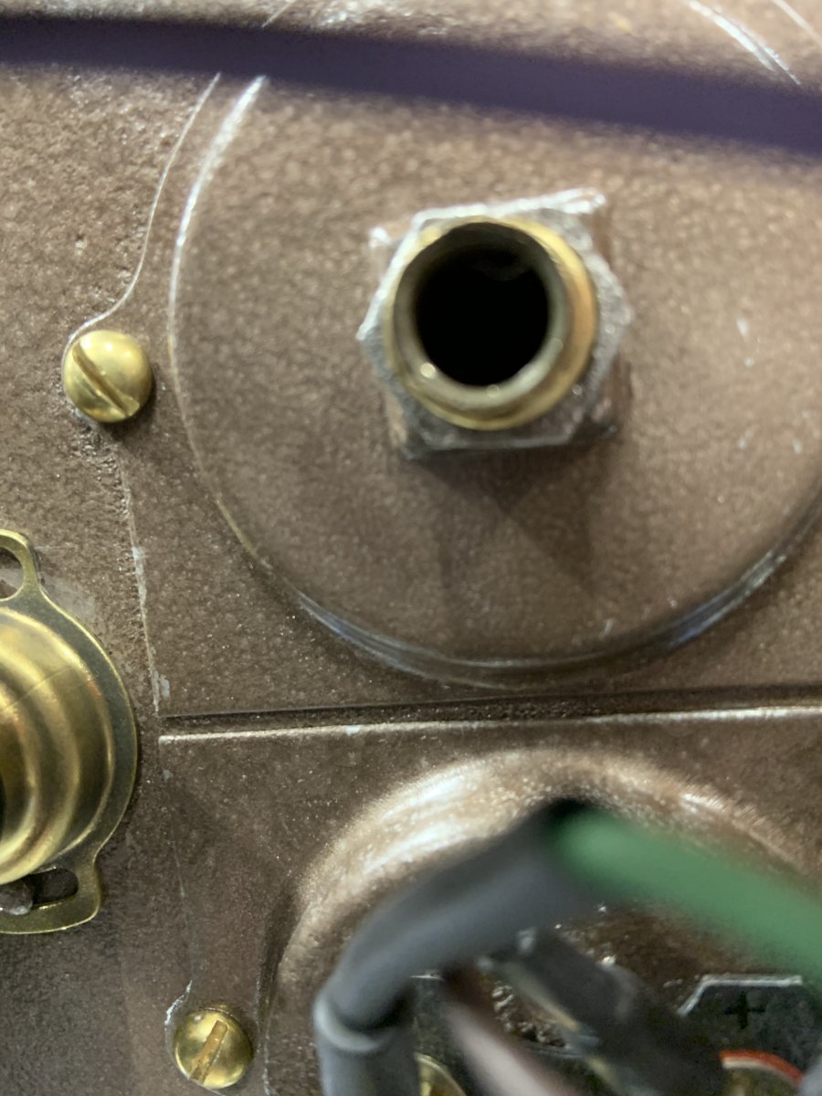

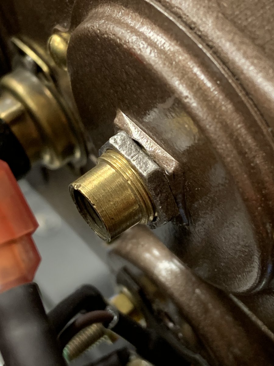

    Pics of opening in back of the gauge 66DA44F3-CCAA-47B0-B5CC-9302ED91FBD8.jpeg 24A3DDF8-4A1E-42F2-B735-11C2D2401F18.jpeg 387ACF20-3D8C-4BC4-8947-2956544D2A48.jpeg
  17. Budget36
    Posts: 15,392
    Budget36
    Okay, looks br***. I’d bet a dollar to a doughnut that a 3/16 ferrule will work. Br*** seals well. If concerned, I can tell you what to do to save the ferrule.
    Dino 64 likes this.
