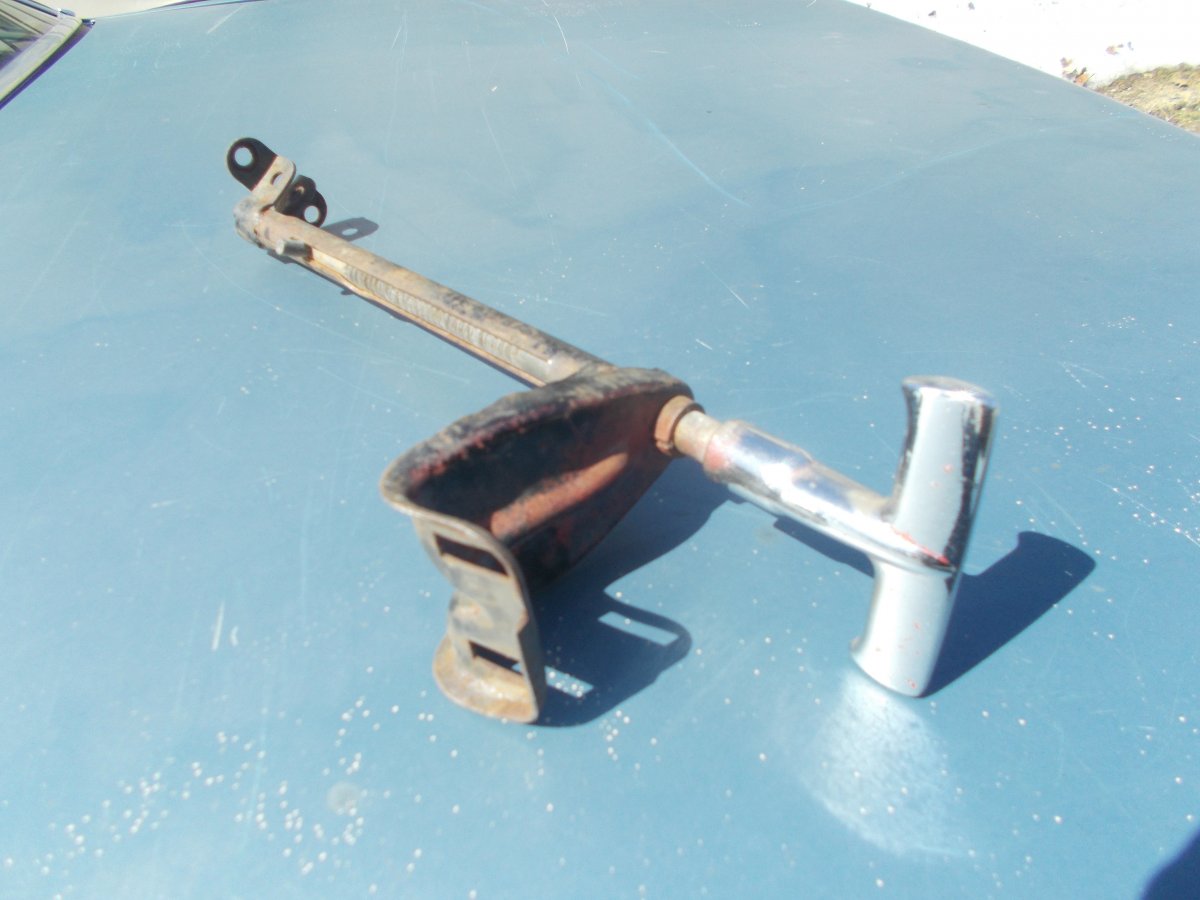

    Bought an '09 mustang floor mount emergency brake ***embly, then tried a '47 ford emergency BHA, couldn't find a good, comfortable location in my '30 coupe... fat belly, short arms...
    Called a buddy, and in 2 seconds he said try a '50's to '60's merc... a pull to stop, and twist to the left to release T handle...
    For $12 i picked up a '53 mercury emergency BHA... should be very similar right up to the mustangs...
    The most out of the way unit I looked at... needs a pulley for the cable end to turn 90* and run down the inside of the firewall... happy...

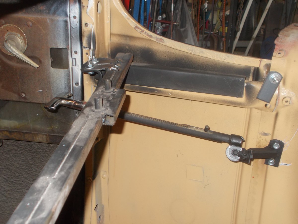

    Warm day... mounted the stock '53 Merc P B handle's bracket to the steering column mount's cross brace...
    another small bracket bolts through the hidden by hood cowl sides and the firewall...
    the pulley is at an odd angle, I'll check it when the cables show up...

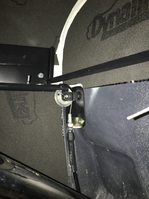

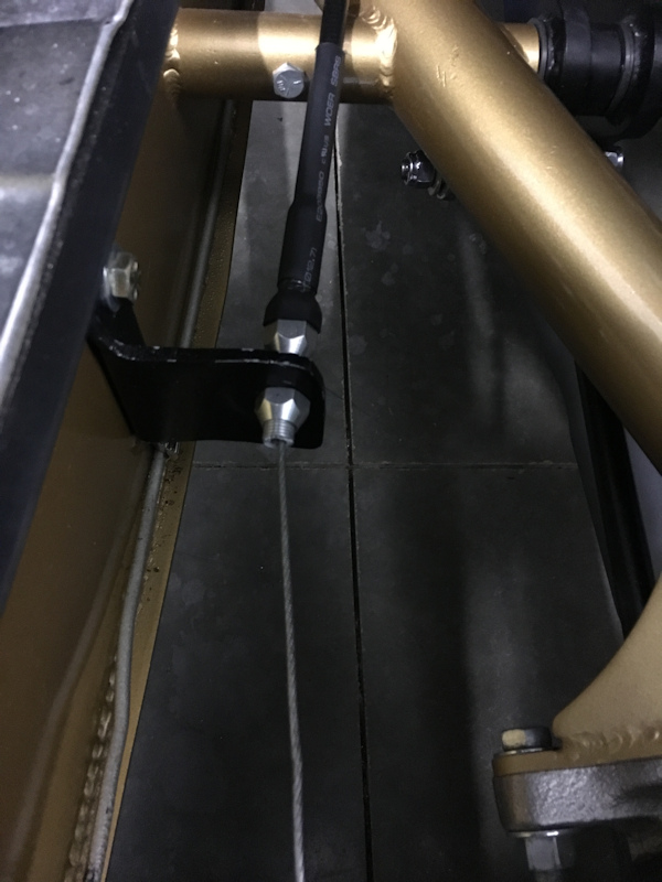

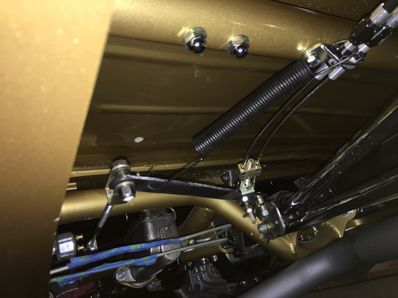

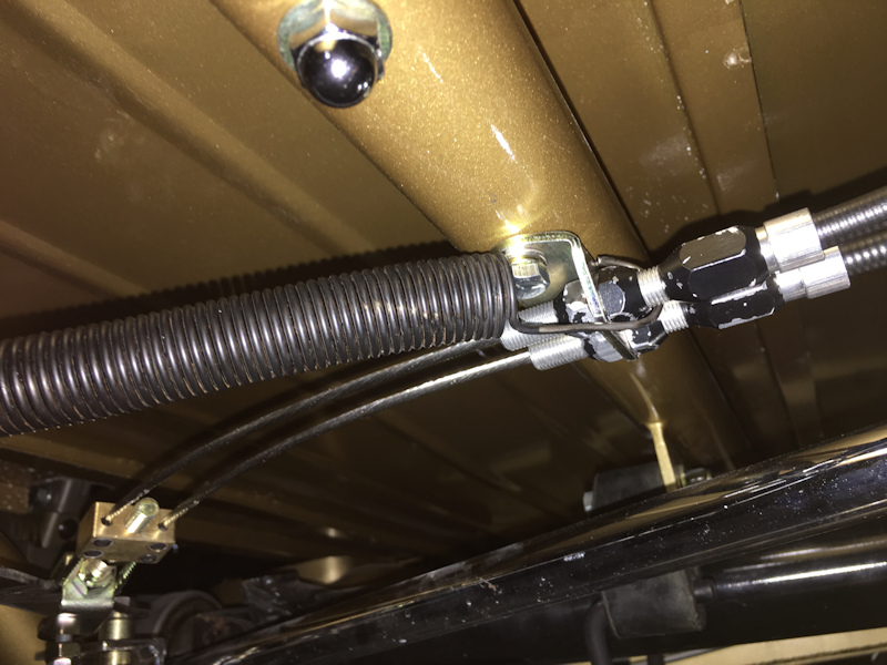

    An update for all who helped me. THANK YOU!
    I got this to work by doing two things: (1) I trimmed the cable spring inside the drums by 1" as noted by olscrounger (he suggested 2" but i found 1" was enough), and (2) added a lever into the system. I couldn't get a 5-1 ratio as suggested by tomastudor, but found a 4-1 ratio worked perfectly with no excess pulling required.
    So here's the completed project:
    1. Pic1 - '56 Vicky t-handle shortened 1" to fit under the '32 dash
    2. pic2 - bracket from t-handle to hold cable on the way to the lever
    3. pic3 - lever attached to bracket which is mounted on the bolt for the left ladder bar, and,
    4. pic4 - bracket between lever and brake cables to drums.
    Thanks everyone for the ***istance. I had more hours in this thing that I imagined, but it works great!!
