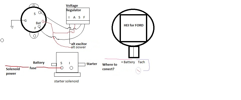

    I have question for the hammers.
    Please help me. I have been told > Just connect it to a + postive power source and all is good. Does it connect to the solenoid, the voltage regulator, the fuse box, a relay, a resistor?:confused:cI have made a picture.
  2. landseaandair
    Joined: Feb 23, 2009
    Posts: 4,485
    landseaandair
    from phoenix
    Just connect it to the "ignition" lead on the keyswitch. No relays, resistors or solenoids needed.
  3. gas pumper
    Joined: Aug 13, 2007
    Posts: 2,959
    gas pumper
    you want a 12v source from the ign switch that stays at 12v while you are cranking. And is 12v while in the on position.

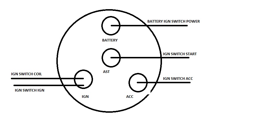

    Thank you. I see now that I should conect it to the IGN. side of the keyed switch. I am understanding this correctly?
  5. landseaandair
    Posts: 4,485
    landseaandair
    from phoenix
    Correct, IGN post in your image.
