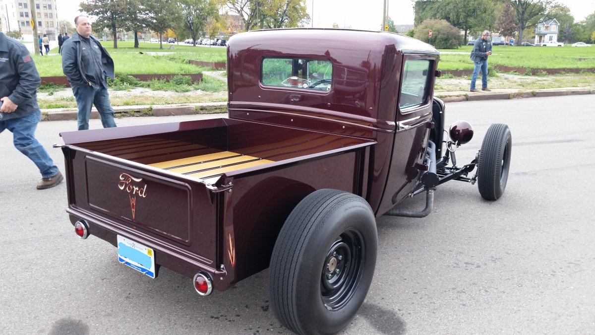

    I'm running a pair of L78s on 5" wheels on the back of my car....they work. It was pretty common to put big tires on narrow rims on the back of a hot rod in the old days.
    sandman460 likes this.

  13. big duece
    Joined: Jul 28, 2008
    Posts: 7,052
    big duece
    from kansas
    ^^^^^^^^^^^^^^^^hubba hubba, that's a cool roadster.
    Paul likes this.

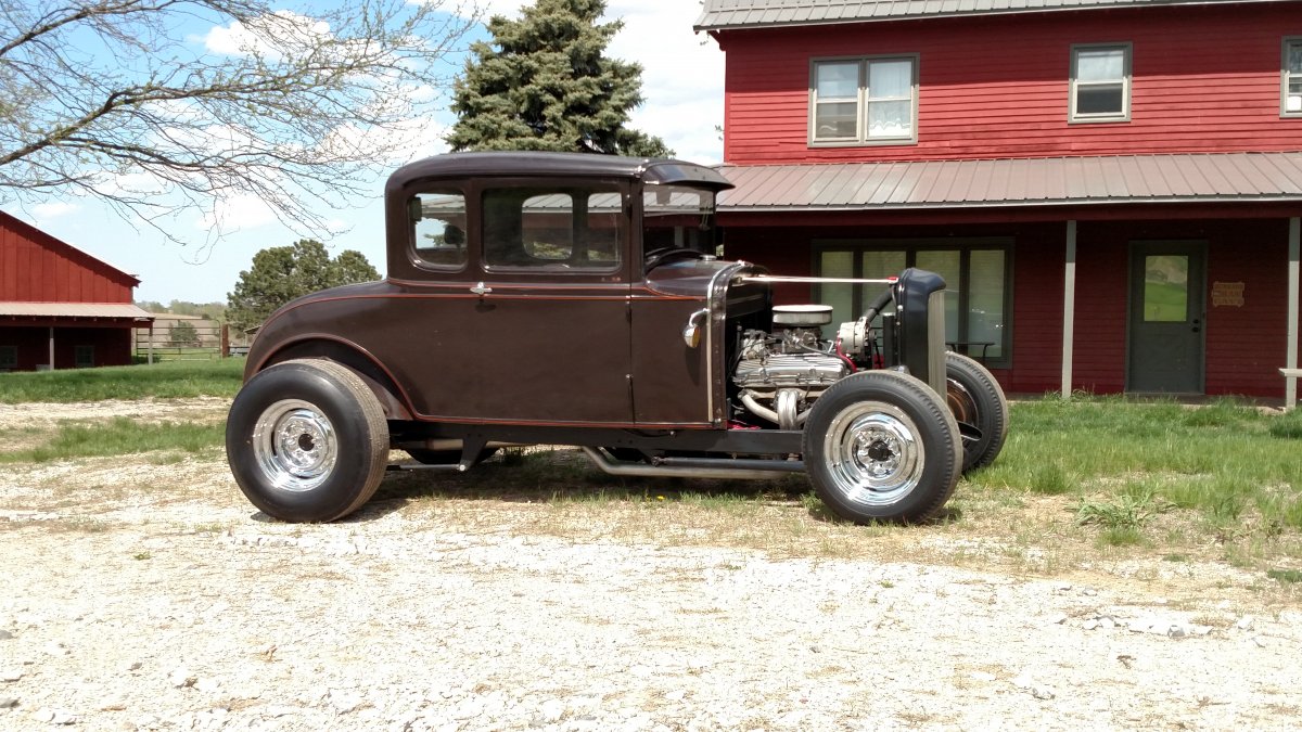

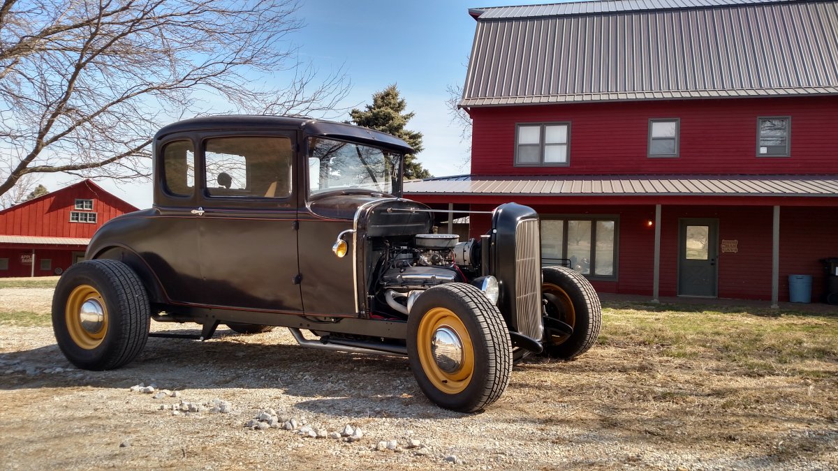

  17. sandman460
    Joined: Aug 20, 2008
    Posts: 16
    sandman460
    from Nebraska
    15x7s were the way to go, thank you all for the replies. IMG_20180506_152507673.jpg
    WC145 and Paul like this.
