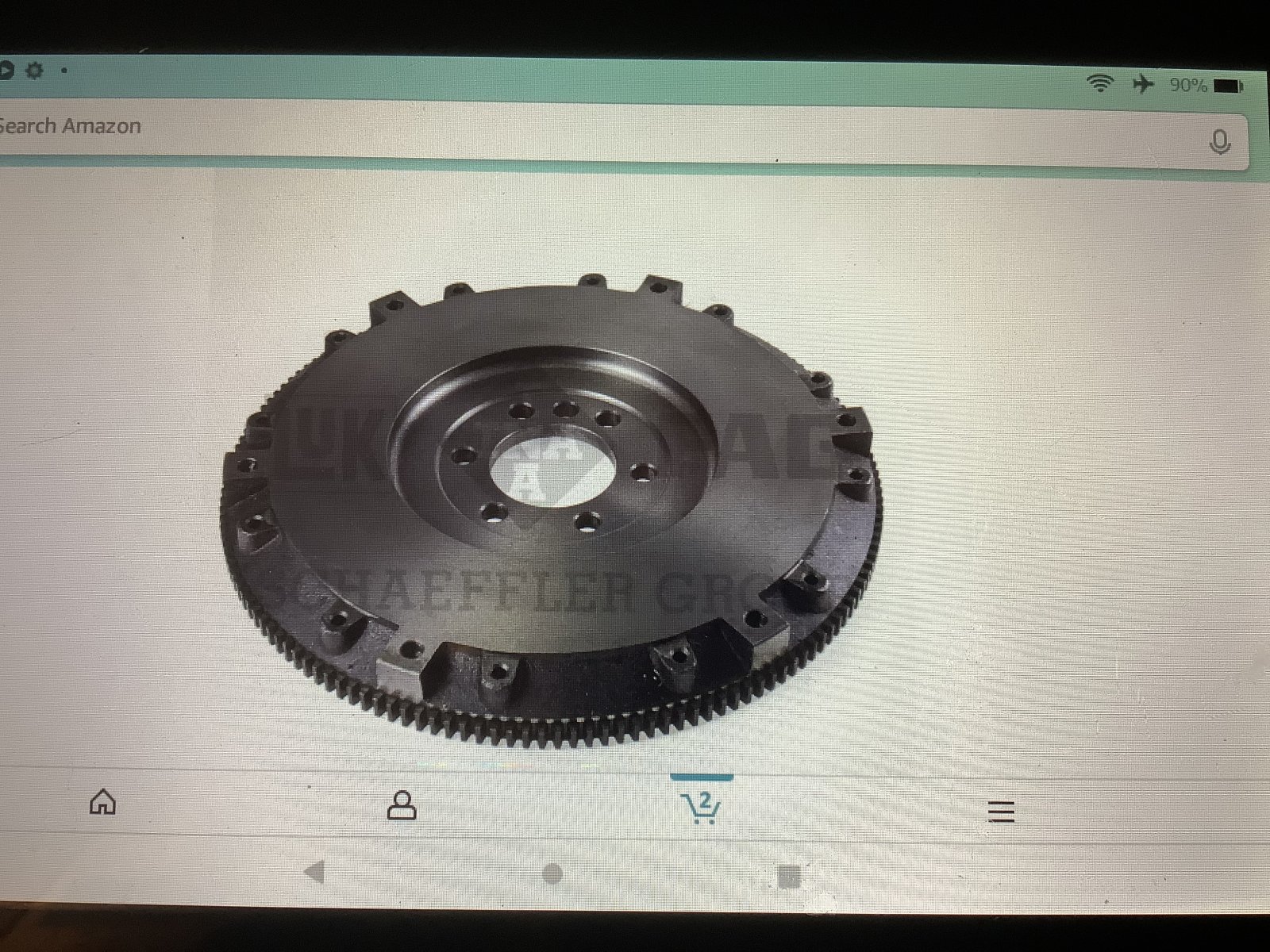

    I recently purchased a 383 sbc for my ‘40. This new motor has a one piece rear main seal so I have to purchase a new balanced flywheel. I found one but it states that it’s for 10.5” or 11” clutch. I’m using the 10” clutch. Will this flywheel still work with the smaller clutch package. I would also like to replace my pressure plate which is a bork/beck 10”

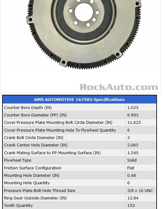

    you could measure the PP bolt circle on your pressure plate, and you could do some research online on new flywheels, and see if it matches. I just picked a random application on rockauto to show you where the info is

    I think the new flywheel you are looking at has the mounting holes outside the flat surface the pp mounts to . The smaller 10” pp would need to be redrilled , and that may be impossible the way the flywheel is cast . Ps , these flywheels are lighter than an original gm .
  8. gary macdonald
    Joined: Jan 18, 2021
    Posts: 453
    gary macdonald
    Here is one I am considering for my sbc to ford conversion.
    If I had to redrill theflywheel 1/4 “ for a 10” it would be difficult due to the way the flywheel is made .

    My self I have drilled & tapped different
    Bolt pattern as long as there enough flat surface area
