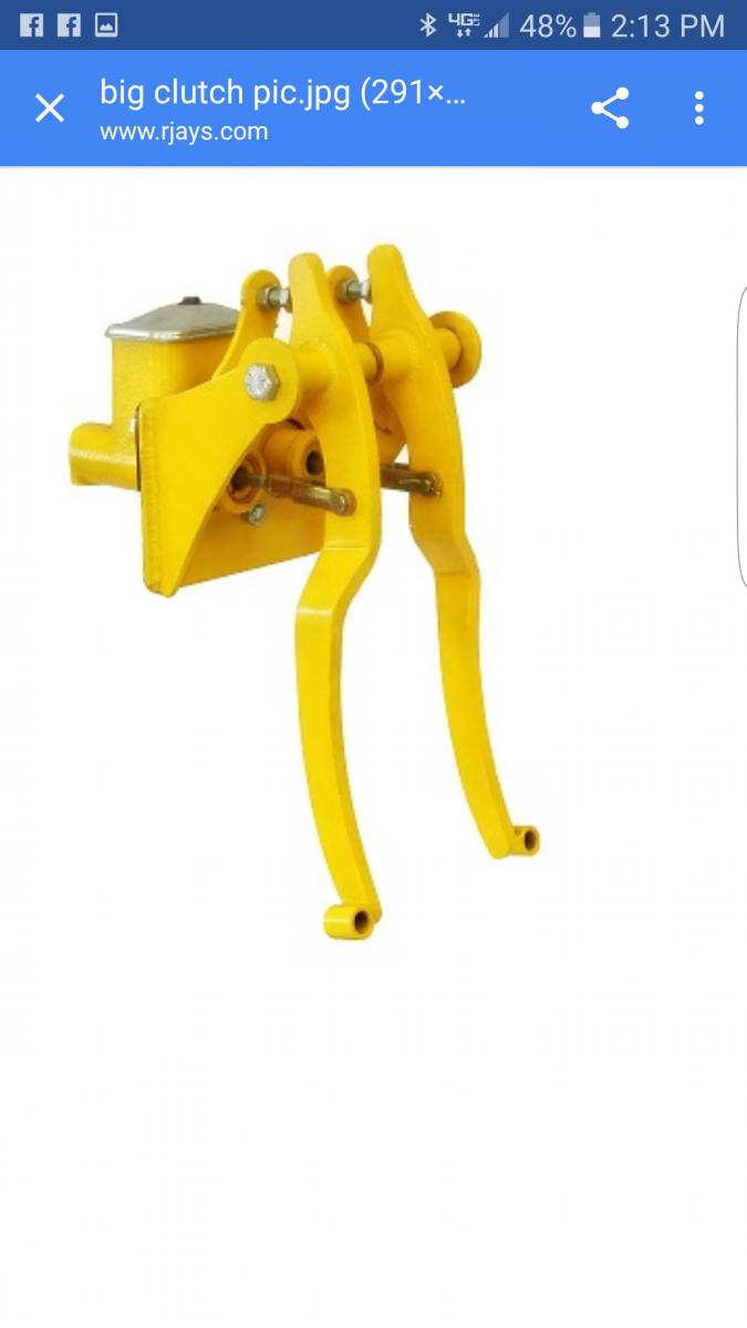

  1. Hi guys. I'm thrashing on my latest 32 Tudor project and the clutch has got me stumped. The clutch takes an excessive amount of pedal pressure to disengage. I'm talking two men and a boy to get the job done.
    I'm running a set of RJays hanging pedals with 1961 GM truck master (with 1 1/8 bores) and a matching '61 GM slave (with 1" bore). The trans is a 1939 Ford. This is the exact set up (other than a different brand of hanging pedals) that I ran on my gold Caddy powered truck a few years ago.
    Having used the set up before, I'm going crazy trying to figure this one out. The master and slave are matched and the pedals ratio seems OK?
    I don't think it's a mechanical issue with the pressure plate. I can but a 13 inch long bar over the trans lever and manually disengage the clutch. It's looks to operate normally through the inspection hole. It disengages hard this way, but I'd expect it to with only a foot and a half of leverage.
    Any thoughts are appreciated as I need to ****on this thing up ASAP as it goes to interior on a few days.
    I've included pics of the pedal ***embly and of my slave mounting.
    Thanks in advance.

    Your final pedal ratio works out to about 3.5 to 1. I believe that is most of your problem. A master with a much smaller bore will help or alter the ratio of the pedal ***embly or both

    Went back & looked at the pedal photo & have to agree with "RICK R 44"
    looks like the pedal ratio is way wrong, needs to be closer to 6 to 1.

    Granted we are working from a photo but the pedal ratio kinda looks like about 4-1. If I put 50# force on the 4-1 pedal that will be 200# on a 1 1/8 master cylinder and the output is only 202psi, or 200 X .99, the .99 value being the area of the 1 1/8 bore. That 202psi x the area of the slave bore (1") is 202 x .78 or only 157# pressure applied to the clutch lever. Doesn't that slave need to be bigger than the master, or is my thinking all wrong?

    Use 1" bore slave..3/4 " bore master...and a pedal ratio of 6 to 1.....
    Simple math to calculate pedal ratio..measure from the pivot to the clevis..then from the clevis to the foot..
    Simple formula...12" foot to clevis..2" clevis to pivot =..6 to 1 ratio..
    More info..
    Power brakes...4 to 1..big bore master Cuz the booster dies most of the work..
    Manual brake..6 to 1 smaller bore master Cuz your leg does all of the work..
    6 to 1 equals more leverage...

    Since the master and slave are a matched set from a factory GM application, I'm totally buying into the pedal ratio being the problem.
    Now the question becomes how can I modify the pedal ratio without changing the mounting bracket where it mounts to the firewall? I'm trying to avoid getting back into the paint again. I can slice and dice the anything inside the firewall no problem. Do I need to move the pivot point of the pedal closer to the center line of the master?

    You would move the hole in the pedal up in the master push rod pivot point.

    So if I get this right, I'd have to cut the side mounts and move the pedal pivot down and then redrill the holes for the master clevis somewhere near the green dot in the photo?
