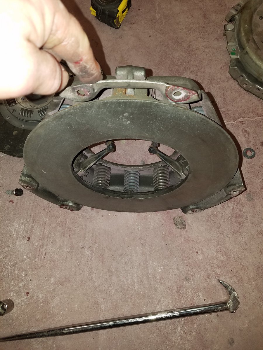

  13. Well got pissed and tanked the engine. Put a 13" long box end wrench over the clutch lever and it was all I could do to disengage the clutch. Not to 20170102_203925.jpg 20170102_203826.jpg surprised by this.
    Pulled the pressure plate in hopes of trying my 10" diaphragm p plate. No luck the one on the engine is an 11". This thing looks pretty beefy with 9 sets of springs. Most of the early Ford stuff I've seen have only 6 springs. That could be part of the problem too???

    There is a number for a diaphragm that I saved when I saw it posted on Ford Barn, it's a NAPA CA30, but unfortunately that is a 10" and BTW, your present PP is Long style. When you mentioned it being a Borg & Beck I commented on it being from a '49-'53 Merc, but it's an 11" Ford truck Long style PP.
  15. Aaaahhhh, thanks for the education @Fordors. So it is an 11" Ford truck unit. What years was it used?
    No good rebuilders in my area. If can get a diaphragm style to replace it, will it be worth swapping over? This p plate is way beefier that the one in my previous truck. That may be why the same basic components aren't getting the job done. That and a bad pedal ratio.
