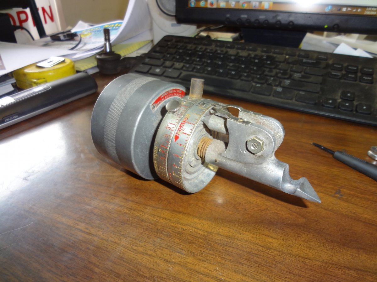

    Ask and E-bay did provide. Finally one came up and I was able to buy it.
    Other than needing calibration, it seems in good working order. The Kwik Ezee website states "A simple built-in adjustment allows maintaining the calibration of the gauge in the field". I'll likely send an email to them to see how this is done. ...even with the device out of production for years, they guy still replies to emails.
    Part of me wants to reverse engineer it and make more.

    Please post the instructions if you find them.

    Yeah I scored mine on ebay for $15 when I first posted this thread! It's the older style that uses the cotter pin hole in the spindle instead of a magnet but that's ok. Its one of those tools that makes you think Wow, this thing is really nice. I haven't done any calibration other than holding against a level and making sure the bubble was centered at 0.

    Stempf sent me four pages of exploded view parts lists and setup instructions as PDFs. I attached them here. Sorry about the sideways and upside down pages. That's how it was sent to me.
    I think mine is pretty early as well. It has a machined spiral vs an internal cam like Hoover's had, and a pointy end. It also lacks the cam on the central post for calibration.
    Hoover's had the internal cam, but a pointy end, making it seem to me like the "#2" design.
    The one on the website has the internal cam and a blunt end, making me think it's the last "#3" version. The one in the website also matches the one in the paperwork Stempf sent.

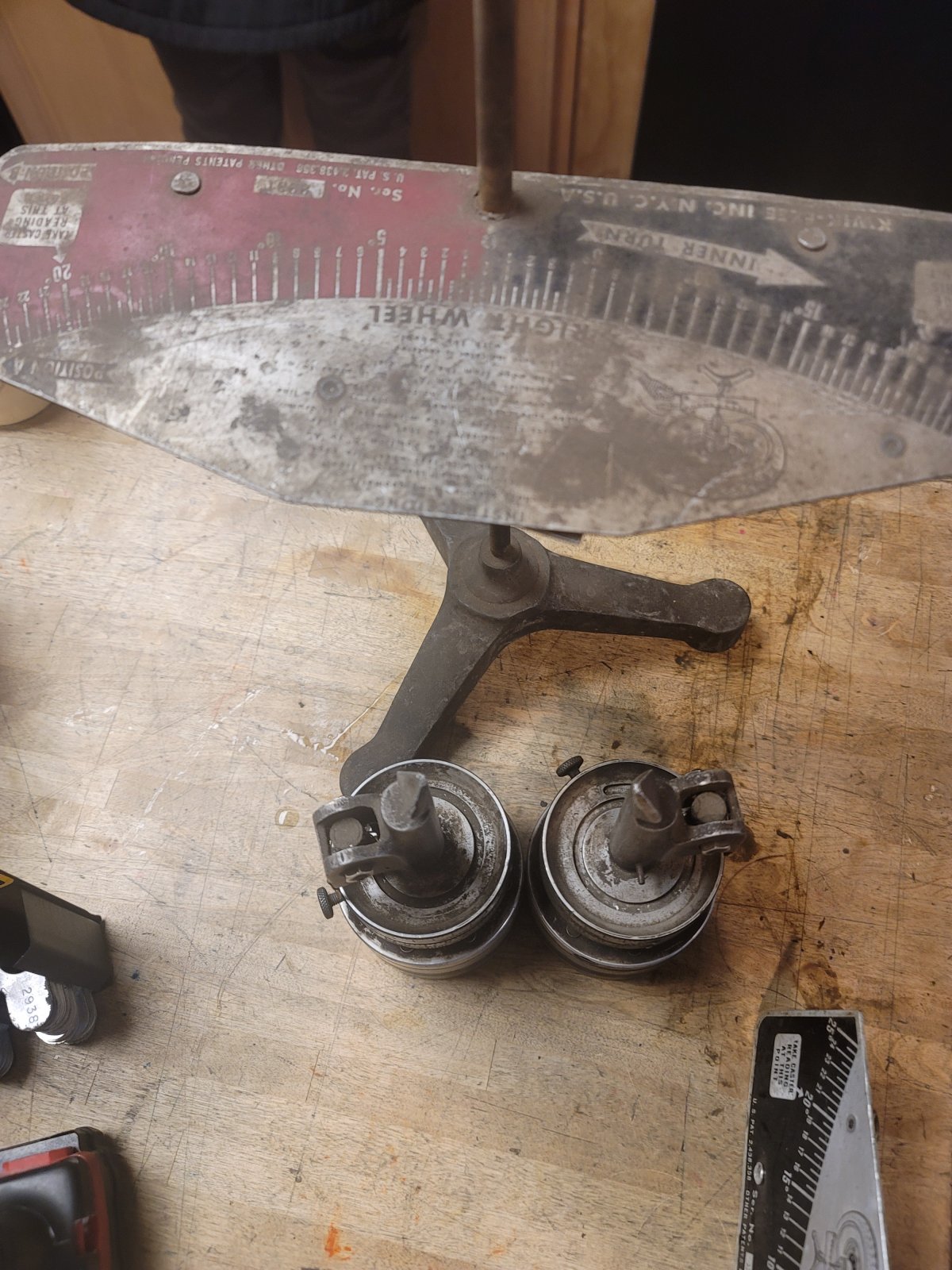

    Just bought these.

    I found the degree scale on Ebay, but not the stand for it.
    Still my favorite gauge.
    I wonder if the maker for these is still around, and if the website can be preserved.
