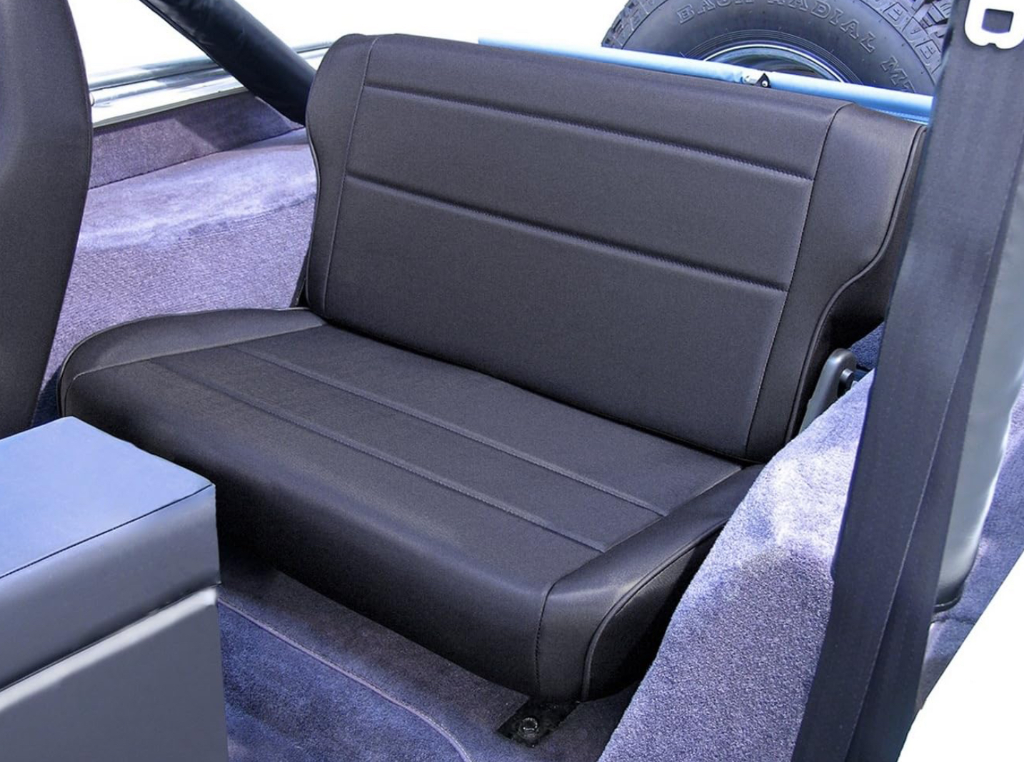

  5. I was going to check the salvage yard but just decided to pick this up brand new for $300.
    If it doesn’t give me more leg room I’ll turn it into a rolling bench seat for the garage.
