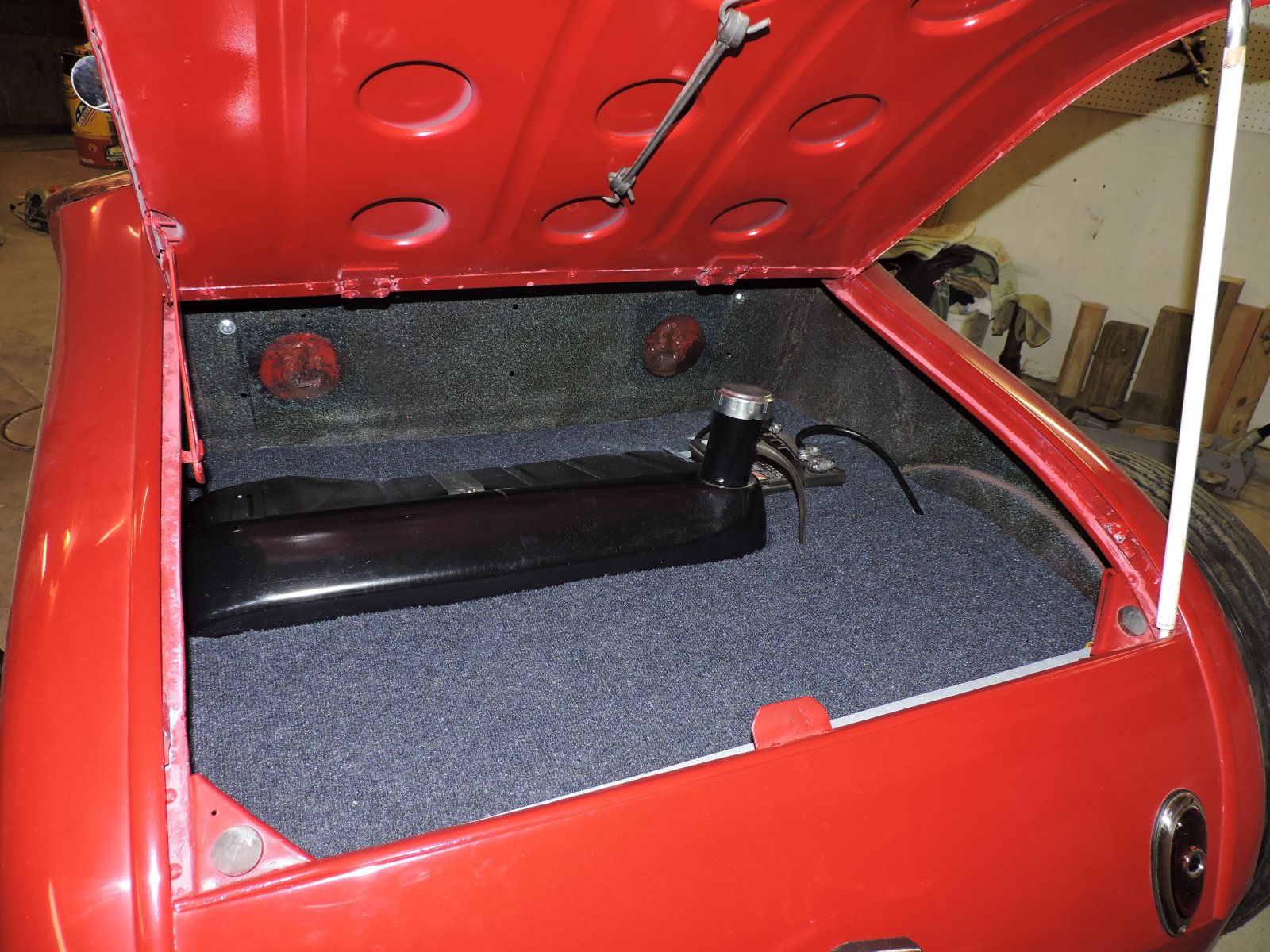

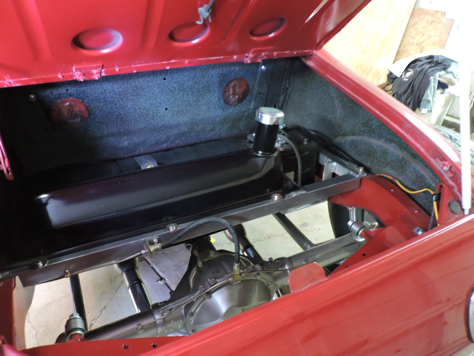

    I used a VW tank from around mid 60s I think. Only about 10 or 12 gal. though. DSCN1176.JPG DSCN1182.JPG
