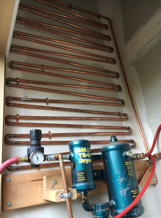

    This is my compressor. I bought it 10 years ago. 5 hp, 80 gallon, 2 stage, cast iron, American made (then, don't know now). The only issue was I fried the motor once, not cheap to repair, about $500.
    If I had to do over again, I would have left the compressor in the shop instead of in a closet outside. I had a horrible wet air issue that I cured with 60 feet of copper cooling tower I sweated together, into a tee, water trap and a desiccant Cam Air dryer. No issues now. Cool idea, the copper down pipe after the dryer and before the regulator supplies my gl*** bead cabinet with 125 psi instead of 80 that my tools get. I have another reg on the cabinet to adjust in the shop.
    The only recommendation I will make is my compressor runs fast, lots of RPMs, It produces lots of heat as a result and works hard when I do. My buddy has a Jenny 3 stage, it runs about 1/3 the RPMs mine does, it runs cool and quiet and no moisture issues like I had.

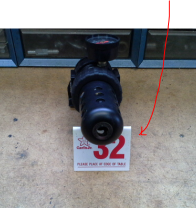

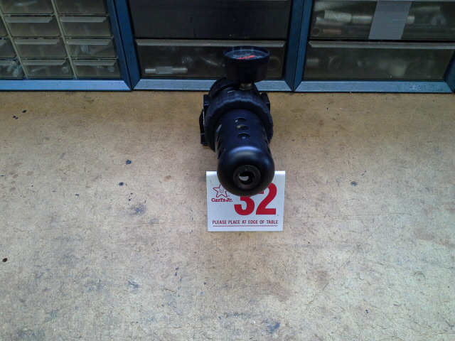

    A not so funny story and a cautionary warning:
    A couple of months ago, about 3:00 a.m., as I let the dog out to do his biz I could hear my air compressor running (still) in the shop, normally not a problem because I would hear it as sometimes I'd forget to hit the breaker when I finished for the evening.
    It had a real slow leak somewhere and would kick on when it got down to the tank pressure setting.
    Never sounded like this before though, as I got closer to the shop I could hear a very loud rush of air sound, went in and put my pants on and went in the shop to find it FULL of very hot, moist, smelly air.
    I figured a glue connection on a PVC joint in the hard line had seperated but it actually was from the fitting on the bottom of the plastic canister on the moisture seperator that had completely blown out. This was a Speedaire (Graingers) unit.
    Very glad this had not happened when leaving town for the weekend.
