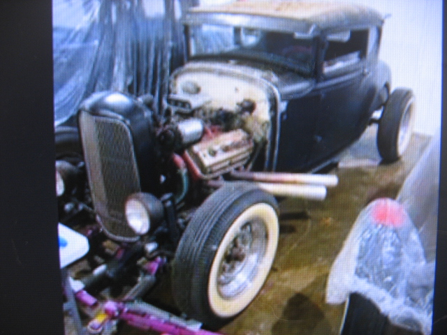

    I dont know any history on it other than my friend bought it in Ohio. It very well could be the same car you are talking about.

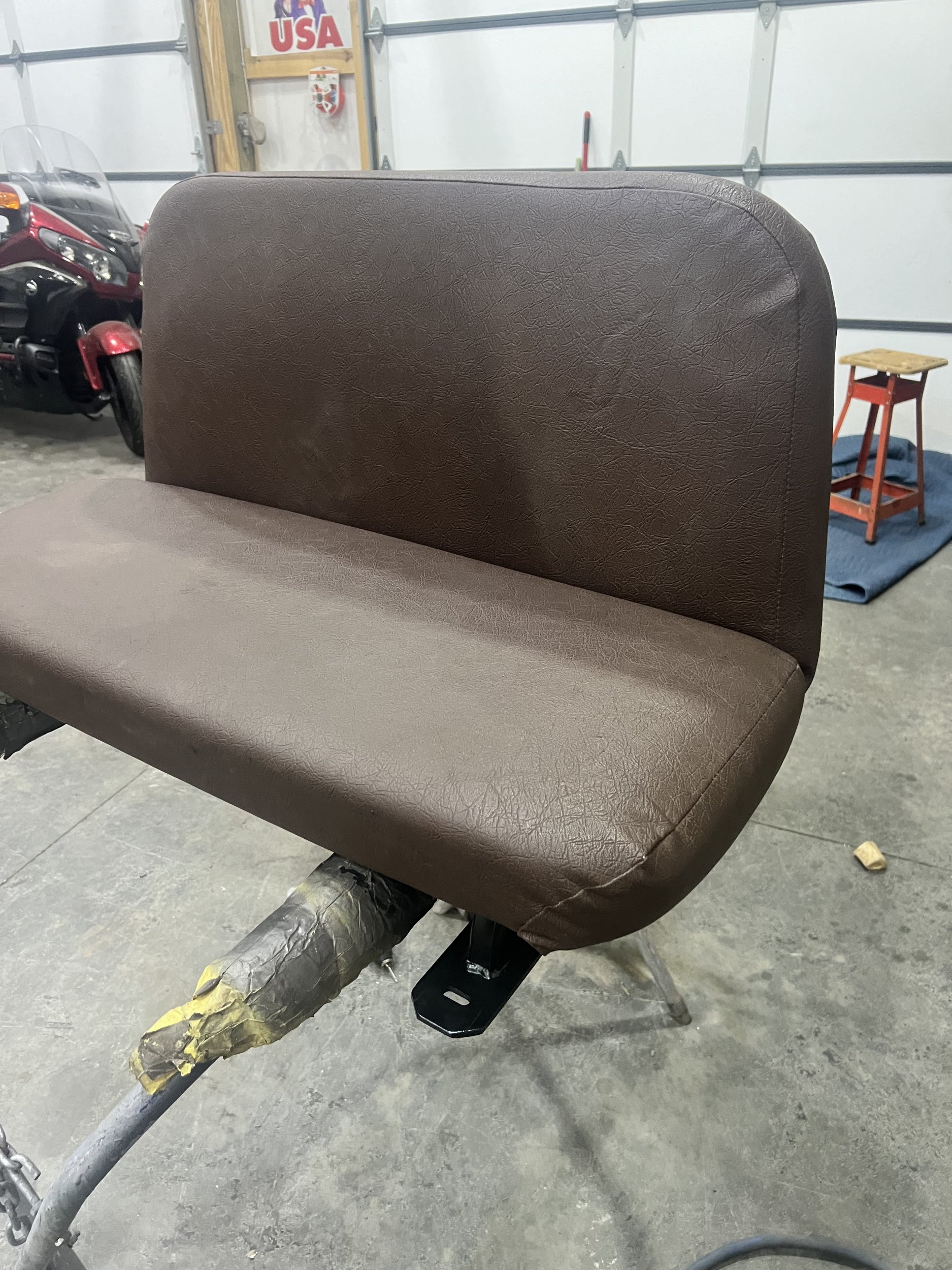

    Mines not a coupe but I did use a 20$ bus seat I cut down and re used the old brown fabric. It worked fine as I was on a time crunch and budget but I’m gonna change it eventually. IMG_4144.jpeg

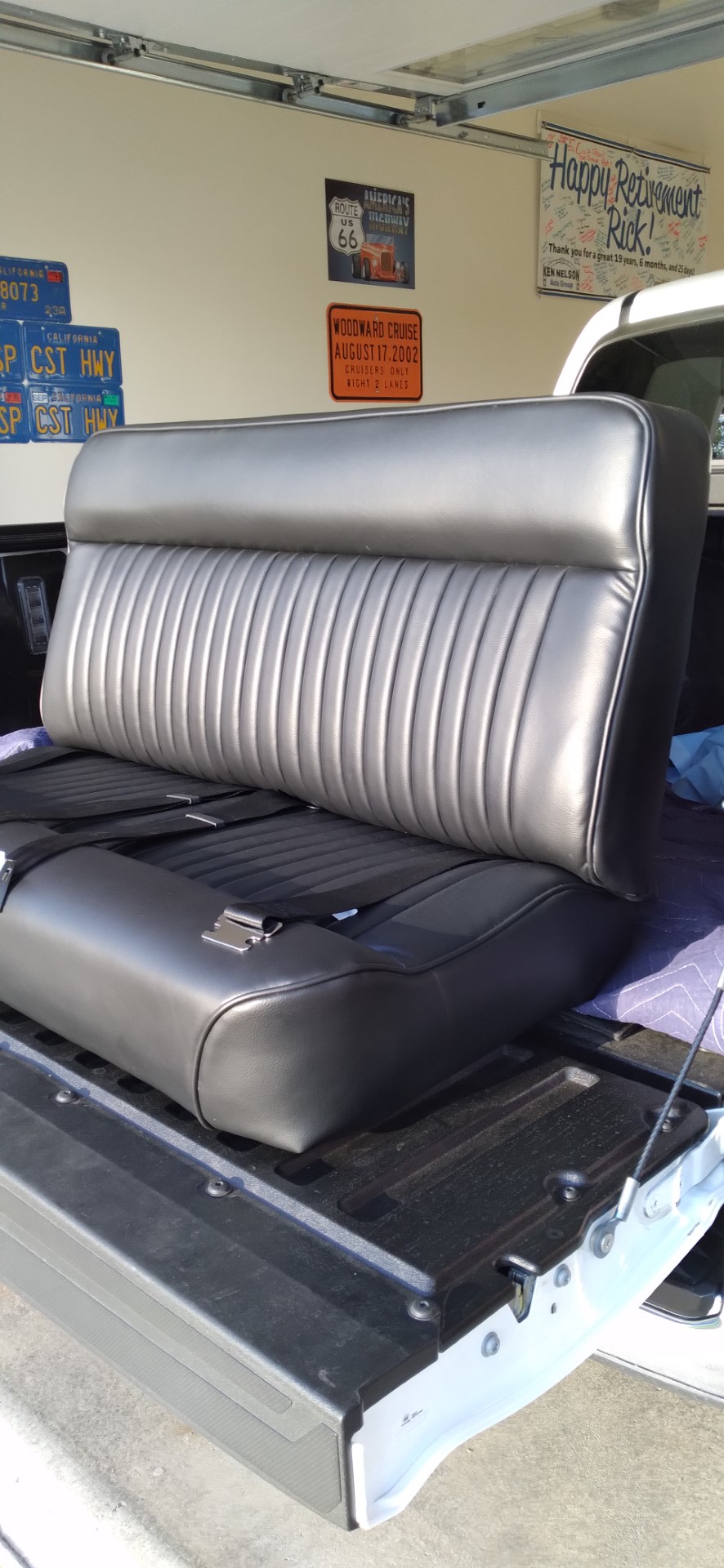

    The middle seat from a Dodge Caravan fits well. You can cover it to look period-correct.

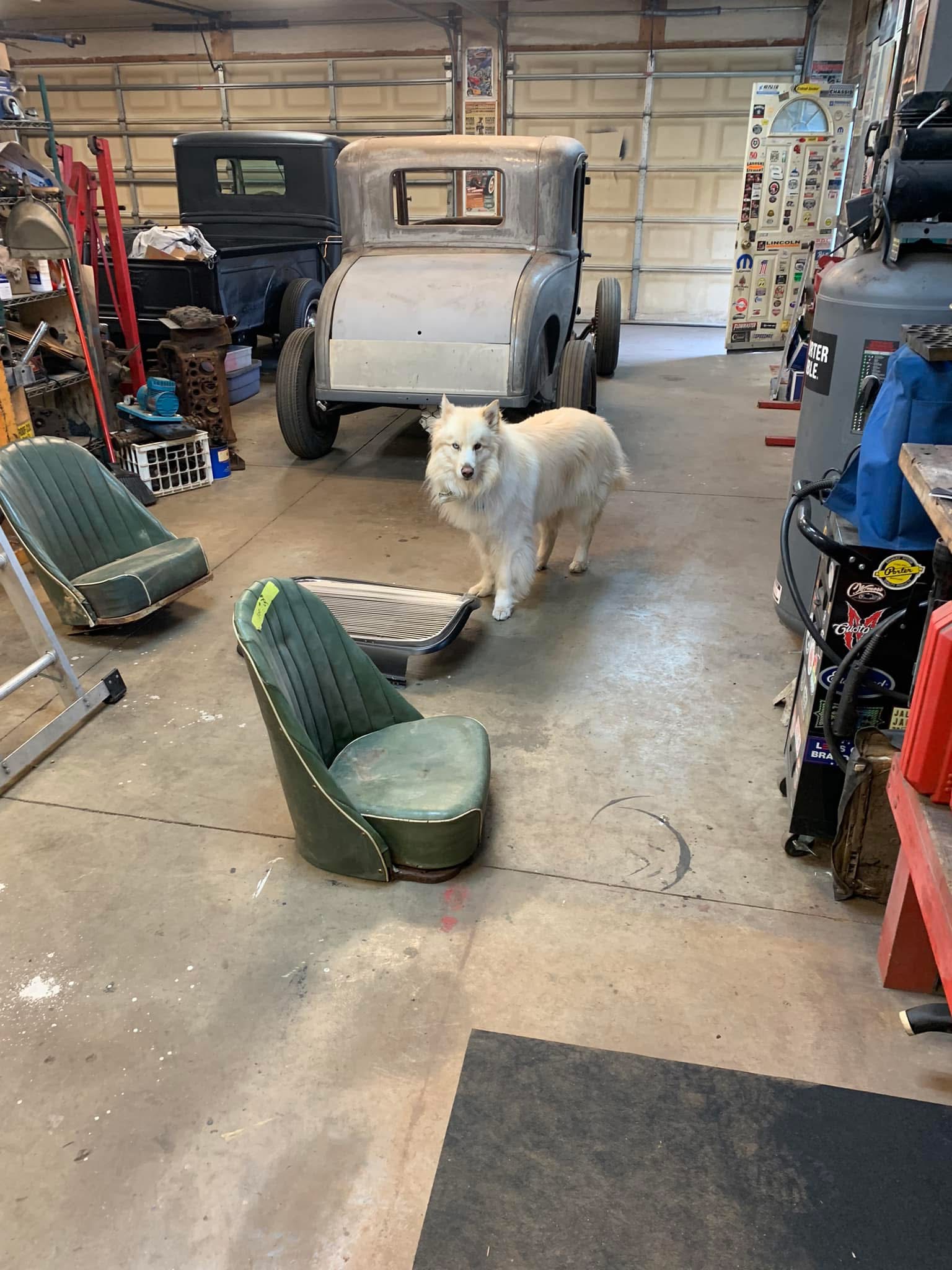

    My Son bought these…with good foam bottom seat pads…they are really comfortable, with no padded seat backs. Not sure they are still being made/sold, but they sure are nice, and work out great in small interiors, like Model A Coupes.

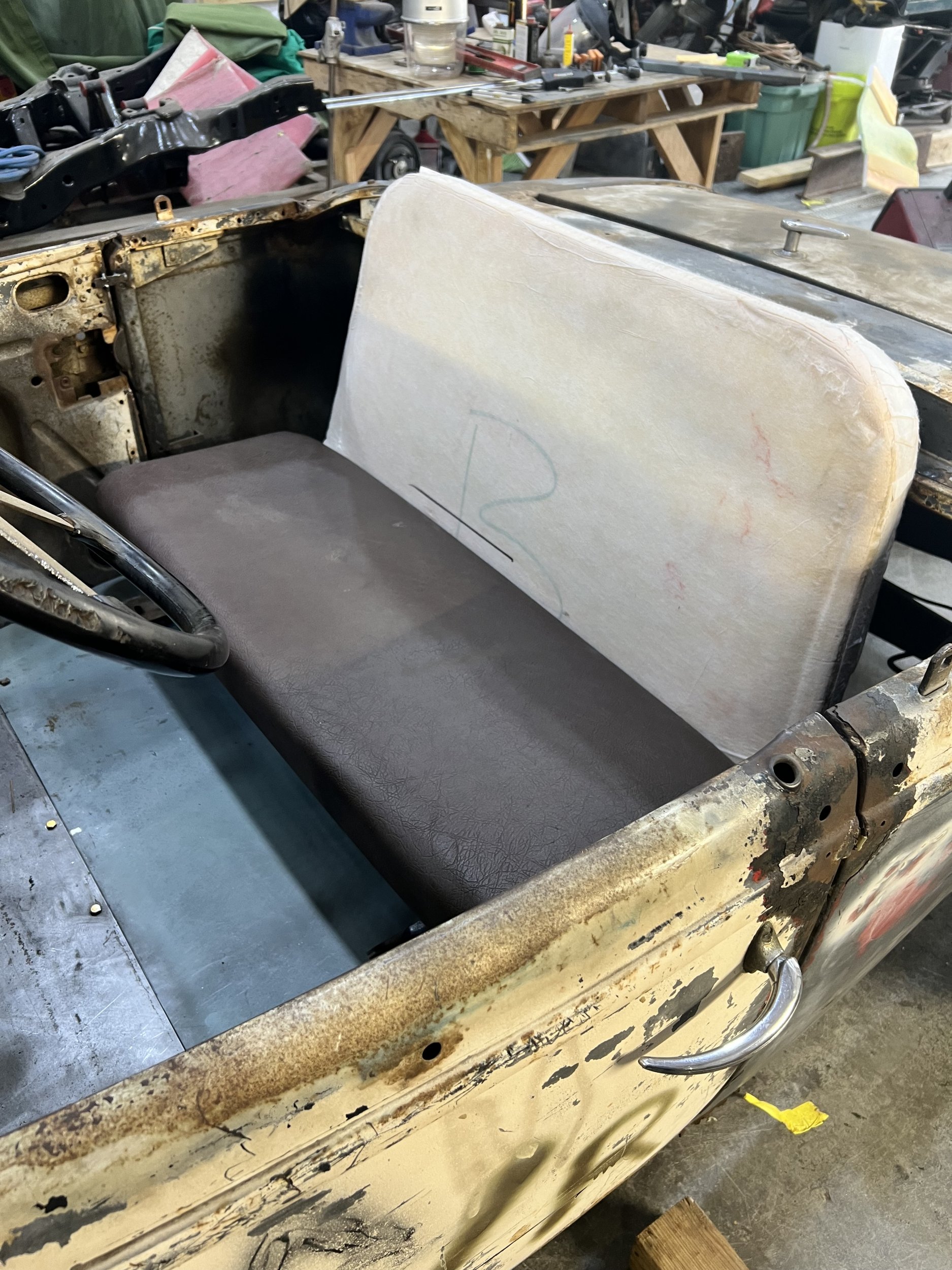

    Bought this one at a swap meet that came from an old Ford pickup for twenty bucks. I narrowed it and lowered it. Now I just got to cover it. Funny thing was the guy who sold it to me insisted it was from a Chevy and when I got to working on it there was a steel stamp Ford emblem on every part. DSC00808.JPG

    I know you said "period correct" but period looking works for me. I used a free 3rd row seat, narrowed and lowered from a Dodge Caravan. I customized it with sliders for 4 inches of fore and aft adjustment. The bottom lifts up for storage underneath and the back folds down for access behind (not shown in pic). You can make it look damn near stock after being reupholstered. Comfortable and the price was right.
