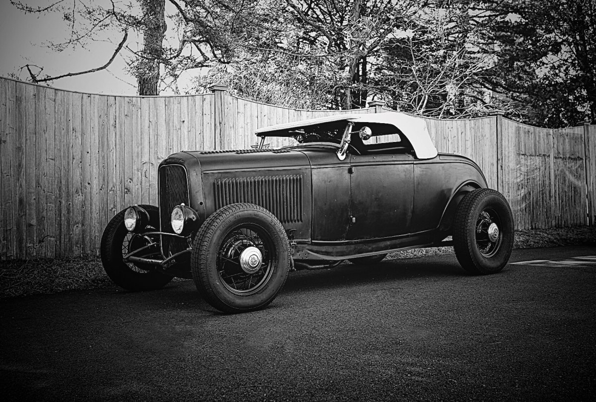

    Been looking at windshields for my 32 roadster. Like the Rodwell but it’s out of my price range. Haven’t been able to see a 3” chop in person. I don’t like 2” chop I have seen in person, probably because there was no rake on the cars I saw at car shows. Curious if anyone has 3” chop windshield, if so could you post a pic of it.

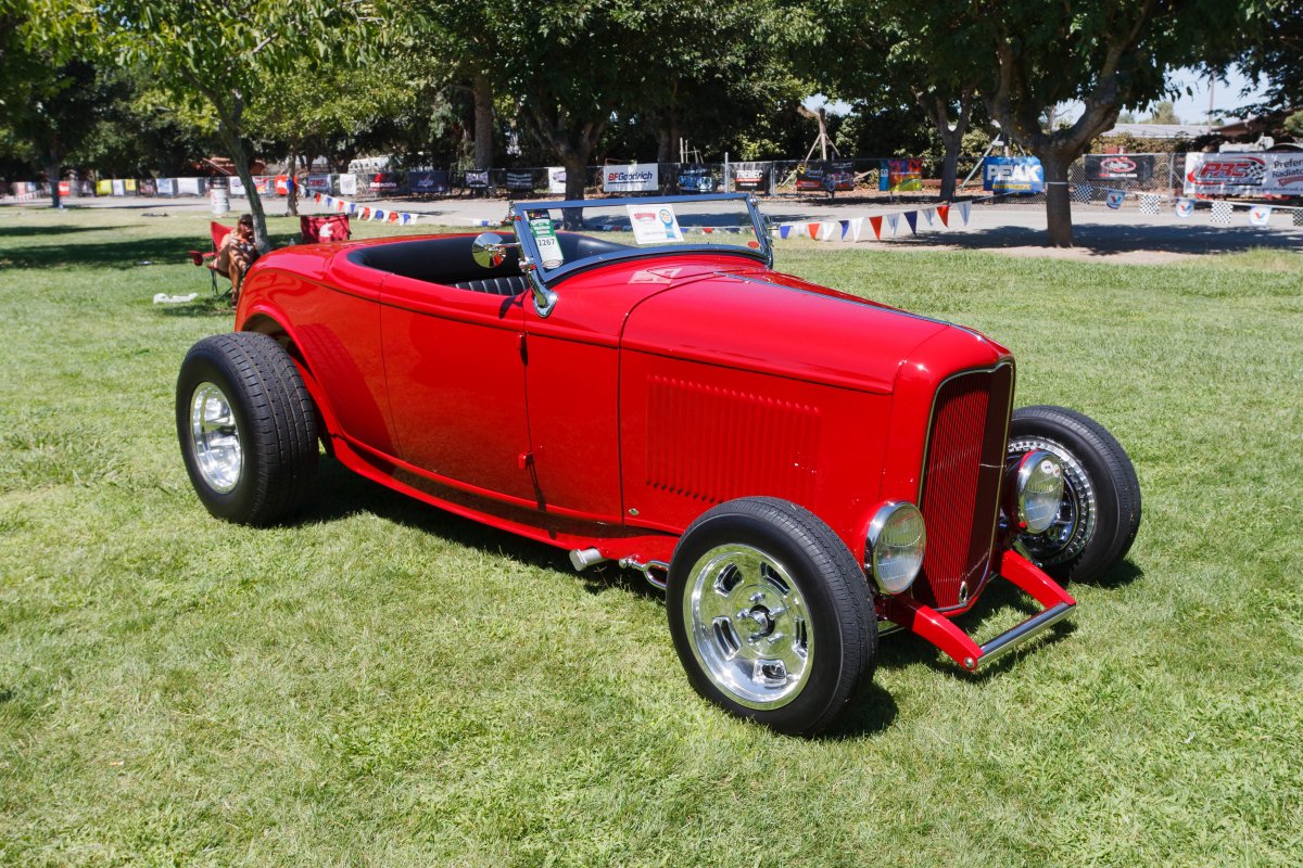

    image.jpeg This is 3 1/4".

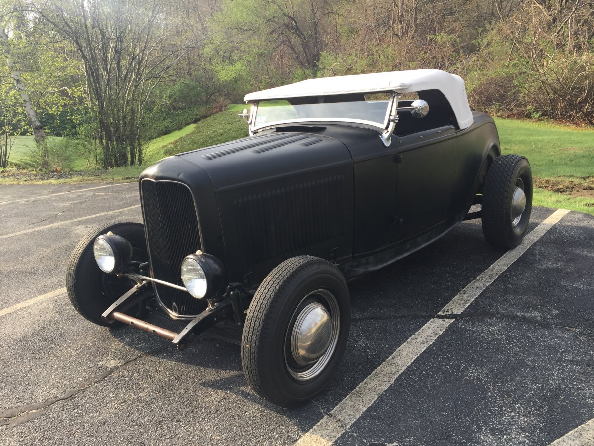

    3" chop with Sid Chavers Bop top.

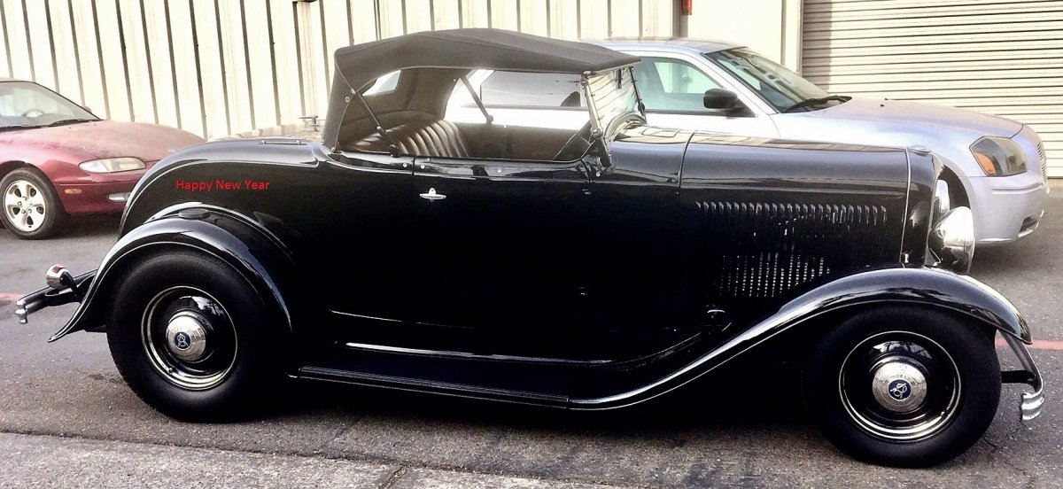

    Original roadster 3" chopped windshield. I'm 6'2" and lowered the seat so I look through the middle of the gl***. P1050522.jpg

    You don't have to V-cut the stanchions, I just elongated the lower hole, and rotated the entire ***embly back.
    Works great.
