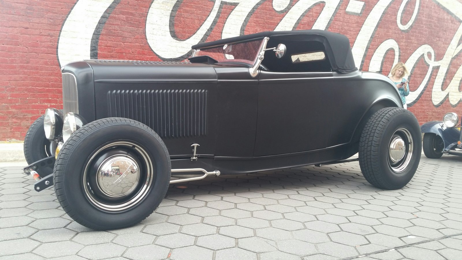

    On the v notch question that's not been addressed as far as I can tell. There's a nub on the upright that bears on the stanchion. This is a stop to prevent the screen falling back further. By relieving the stanchion slightly (v notch) the uprights are able to rotate back further thereby leaning the screen back. Do not mess with the nubs as otherwise there would be nothing preventing the screen from fully collapsing rearward. The v notch can be made in a number of ways. I've done it with a cut off wheel but might have used a carbide bur too. I don't have a dremmel which I guess would work. I'd have done it on my milling machine but I'm limited for clamping methods. Clamping vertically I guess a square end mill would make short work of this task. There will obviously be damage to any chrome whatever method is used, but this should be minimal. And, as with anything like this, sneaking up on it with small cuts, test fit, cut again if necessary, is the order of the day.
    Heres a pic of mine which shows the nub. This is a Rodwell screen so isn't necessarily the same as a stock one (and I no longer have a stock one), but I hope you get the idea.

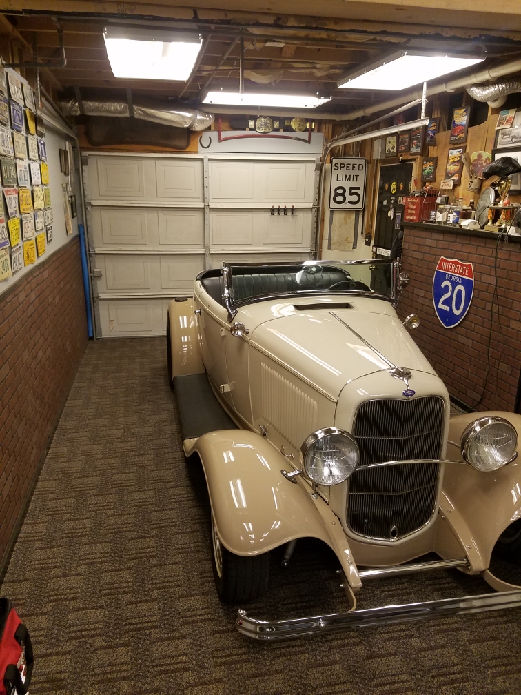

    Both of mine have 3" chops Resized_20180728_200702.jpeg 20150829_183555_resized.jpg 20150719_175206-1_resized.jpg
    rod1 likes this.
