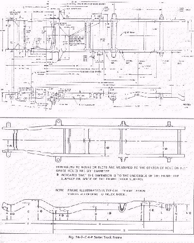

  17. squirrel
    Joined: Sep 23, 2004
    Posts: 59,319
    squirrel
    This is the 1975 truck frame, same for 73-80. 81-87 has a slightly different front end where the bumper mounts, as they redesigned the front sheet metal.
