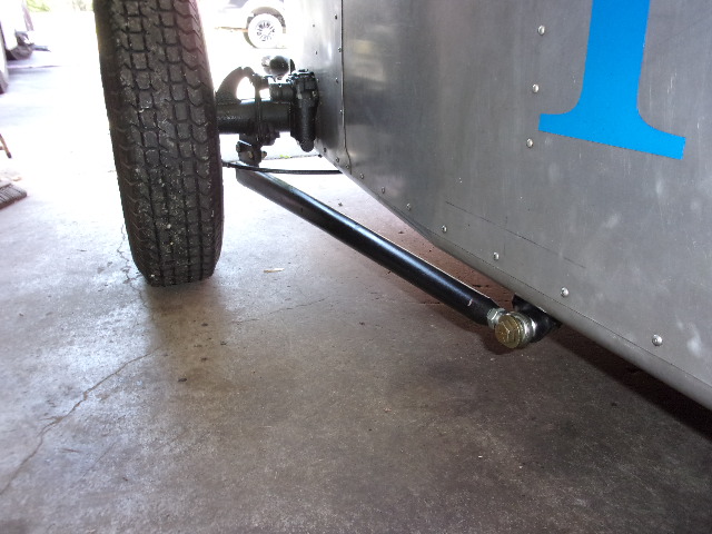

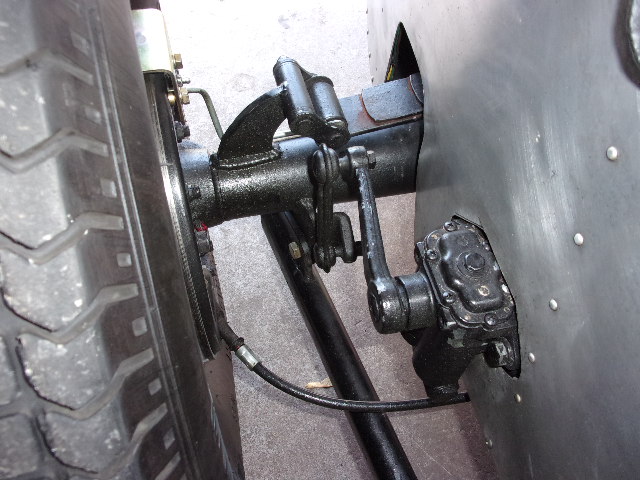

    Some more pictures with hopefully more detail
    Picture jacking in the rear after removing the rear panhard bar. With the bar in place the r/r was almost not touching ground 100_0100.JPG 100_0101.JPG

    On edit: Going back and looking more closely at the pics, Your rear spring shackles are at a near ideal angle and I think a rear panhard bar isn't needed.

    Front springs and front panhard bar. I believe the front bar is required for this front suspension. It sits dead level at rest. 100_0096.JPG

    As I said earlier the split rear radius rods all the way outboard to the frame like this car put things in a binding mode. And like bottoming out, bound up suspension can cause very different reactions to what you would expect, pretty much unpredictable. With the lever action shocks it makes it more difficult to measure wheel travel. With tube shocks a zip tie around the shaft of the shock will give you an indication of travel after a couple of "hot laps"
