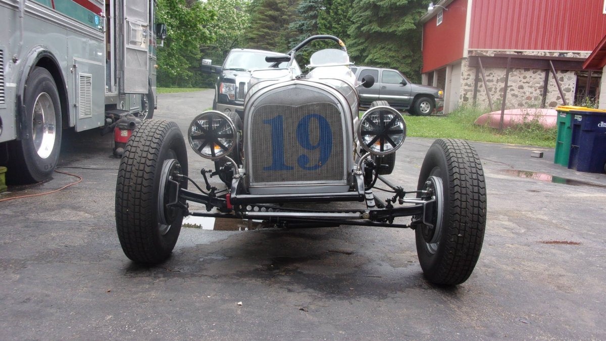

    Not likely. Frame is very stiff due to boxing and additional cross members. Check out the front and rear pics I posted while jacked at L/R.

    Greetings to all involved in this conversation! As has been mentioned by several, roll center height also plays a large roll in determining which end of the car has better lateral grip. I am wondering if the rear radius rods not pivoting on the axle and thus turning the rear axle into an " antiroll bar" ( also sometimes called a sway bar) but the inherent bind may also cause their attachment point to be the roll center height. The front roll center height is largely determined by the panhard bar attachment point heights ( split the difference if one end is higher than the other ) but the quarter elliptical spring attachment also adds some lateral location. If the rear of the ch***is/body were allowed to roll over the rear axle by eliminating the bind and the car still wanted to understeer attaching a panhard bar level and above the center of the rear axle should help....the higher the rear roll center the less the car should " push" ( most American oval track guys term for understeer!)

    Greetings dirty old HAMBer!....you know after thinking on this a bit more and looking at the photo of the racecar in question I'm wondering if the fact that the car appears to be pivoting around the contact patch of the tire on the ground if that has caused that to be the effective roll center?...in 40 years of wrenching on dirt modified oval track cars I have learned that the laws of physics and geometry WILL give an answer to every question if in fact we ask the right question!

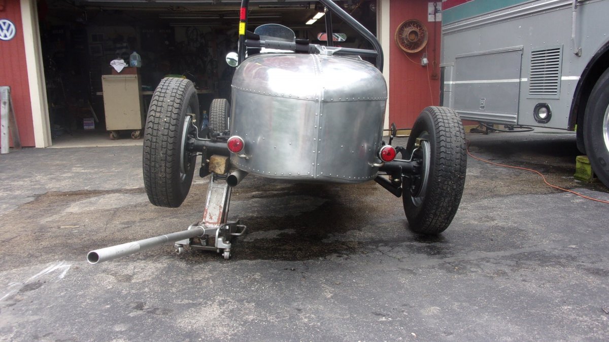

    Try jacking your car under the L/R frame instead of the rear axle ,and have a good look.......
    If you want to be high tech ,then do this with corner scales [the car could be "wedging" and diagonally overloading the front]
    Your car is doing the opposite of what it should be doing. With rear roll stiffness the way you have it, it should have bad oversteer .[but it doesn't]
    You have "Drag Racing" rear suspension in a "Roundy Pounder" Car.

    The problem is the OP's car is "Fighting" the laws of physics, It should be harnessing the laws of physics instead.
    With a high CGH where the driver is sitting combined with a tall engine, there will be a lot lateral weight transfer. With that ladder bar set up it should "unload" the inside rear [causing oversteer on the outside rear]
    But it doesn't do that.........which is the Mystery.
    I am willing to guess the the "roll centre" at the front is very high.
    And combine that with no bodyroll on the rear and the outside front is subjected to increased lateral loads without increasing the vertical loads on the outside front.[Increased load with out the increased grip]
    If the RC was lowered in the front [which also lowers the roll stiffness] it would suddenly start oversteering and the OP would then need to address the rear ladder bar issue.

    What I'm saying is that the rear wishbones aren't really adding a lot of roll stiffness to the rear. I agree that it's never a good idea to have mystery elasticity in a suspension system due to bending or twisting things which aren't supposed to bend or twist, and that includes the frame rails.
    Your guess of a high front roll centre makes sense, but I don't see anything in the pics which would bring that about. The quarter-elliptics' shackles probably provide enough lateral location to obviate the need for a Panhard bar, and as a general rule you don't want several lateral locating devices which might try to fight one another. In this case however, both the quarter-elliptics and the front Panhard bar will impose a roll centre somewhere within the six inches or so below the level of the front hubs, so there won't be appreciable bind there unless the front spring rates are a lot lower than they seem to be. But I'll look again at the pics, just to make sure.
    A technical nit-pick – though I quite understand what you're saying in the present case: a high roll centre doesn't actually cause roll stiffness. Roll centre height is a factor in geometric lateral load transfer, and roll stiffness is one in elastic lateral load transfer. The sum of these (plus inertial lateral load transfer of the unsprung m***, which is usually not easy to change) will give you total lateral load transfer, so the same total lateral load transfer can be achieved by a range of combinations of roll centre height and roll stiffness.
    I'm still stumped as to what is loading the outside front tyre in this case (if indeed it is getting loaded. It could be something quite non-fundamental like a softer tyre compound on the back?)

    I had another look. I don't see anything in the pics which might place the front roll centre anywhere except about 3-4" below the level of the front hubs.
    It's also evident from the jack exercise that there is more roll deflection at the front than at the rear; and I'd say therefore a greater rearward bias in roll stiffness than the probable rearward bias in tyre adhesion. Everything suggests that this thing ought to handle beautifully, with a slight and controllable tendency to oversteer.
    I'd like to take a look at the steering geometry, though. I don't see a bump-steer disaster but it might be improved.

    You are correct about the R/C ,it is reasonably low.
    If we look at this photo when the body is tilted to the left [of the photo] it also shifts/arcs to the left . This puts the RC [pivot point] below the springs near the panhard height.
    I don't agree with your statement "Everything suggests that this thing ought to handle beautifully" [It should oversteer like crazy]
    Parallel ladder bars do not belong on a road racing car , and this car has them both front and rear.
    The car should be neutral on corner entry, and slightly understeering on corner exit [to allow throttle oversteer]
    Some of the engineering needs to be corrected before the OP goes through the tedious task of dialing it in.
    The first thing I would consider is getting rid of that rear ladder bar system by pivoting them at the axle.
    A torque arm [eg: Camaro style] or an upper 3rd link would need to be added.
    Do this and the rear panhard bar won't bind ,and then the dialing in process can begin

    Thanks for your latest comments. I did try jacking on the ch***is in the rear and I only have 4.5 degrees of roll before the tire starts to clear the ground. I guess at this point I'm wondering how much would be needed for it to improve handling? I don't have time to relocate suspension components before the event 7/19-21 so will have a go as is. I like the idea of a third link and pivoting the track bars but not sure where to put the torque arm. Any thoughts on the length the arm would need to be? Space is limited. I can move the track bar front locating points towards the center of the ch***is but only to about 10" a part. Which option would be preferred torque arm or relocate track arms?
