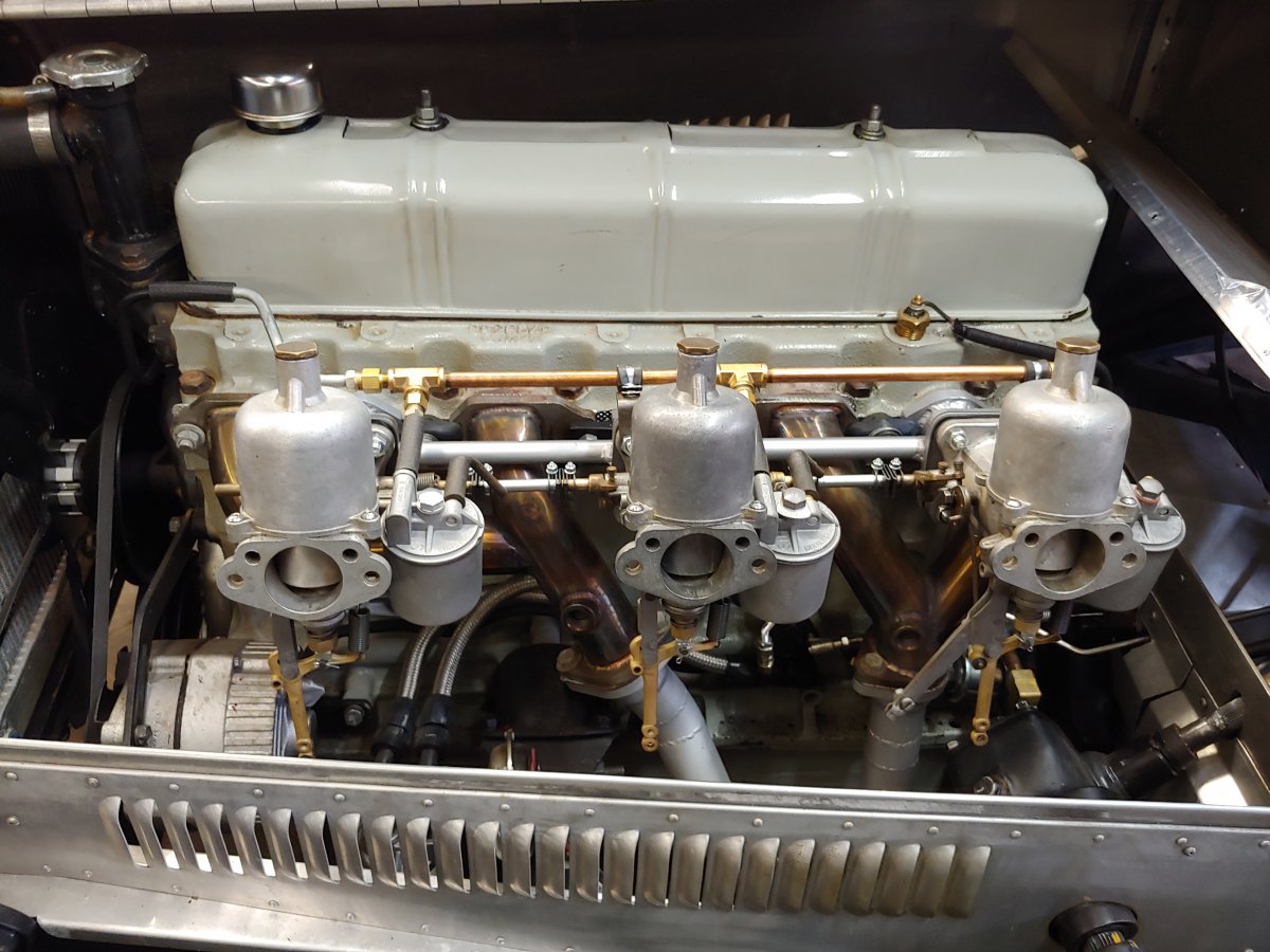

    Over the winter I got a bit bored...And as I got more comfortable with the car I got to thinking about my puny Rochester 1bbl. carb. So something new to fiddle with in addition to handling. Might be a mistake to throw this in now but oh well 0403201312.jpg

  10. seb fontana
    Joined: Sep 1, 2005
    Posts: 9,108
    seb fontana
    from ct
    More power, steer with the throttle. Is the diff locked?
  11. panheadguy
    Joined: Jan 8, 2005
    Posts: 1,102
    panheadguy
    from S.E. WI
    Nope. Got some low speed sharp turns.....and not enough omph
