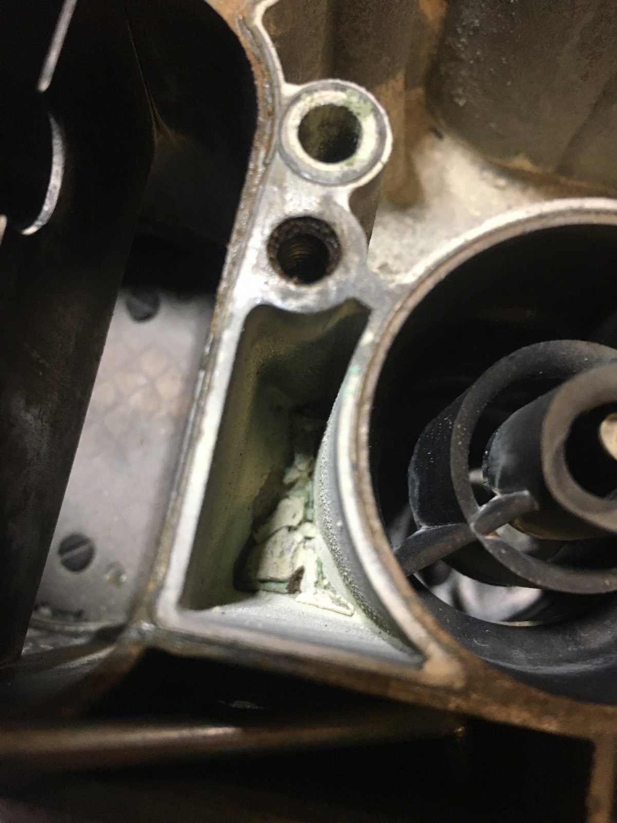

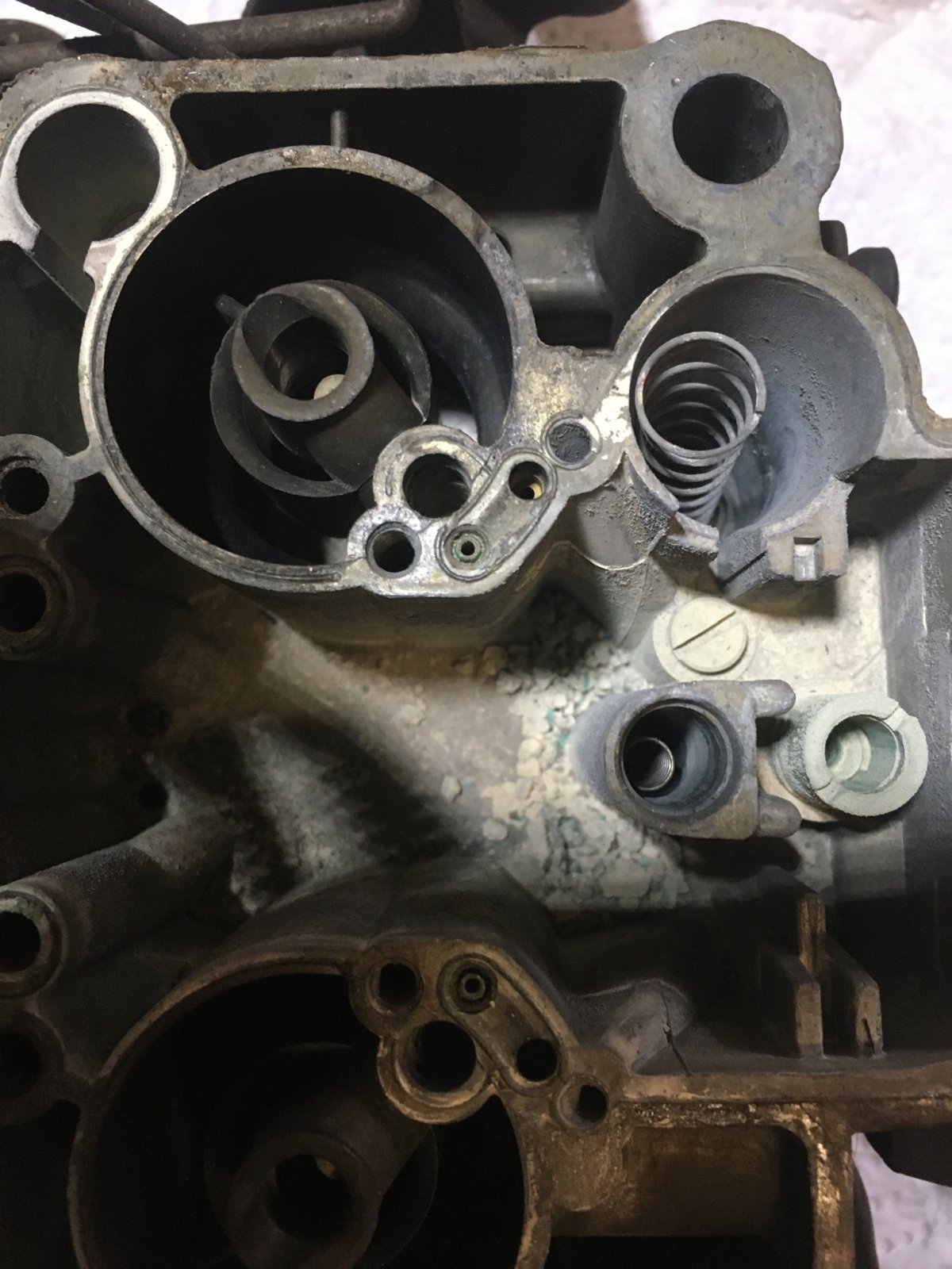

    67CB1AF0-C483-4984-AF47-F675FD85B2D7.jpeg 8349DCA4-26DD-4064-A6B8-BDD12F8D39A5.jpeg 660E51ED-CF4A-42B6-AA7C-9BD341CE4CE6.jpeg 7A952CA6-C1E0-41B8-842F-08783DEDADB3.jpeg 67CB1AF0-C483-4984-AF47-F675FD85B2D7.jpeg It’s best to open up a carb...Craigslist purchase. This is a Quadrajet
    Mark Yac and jimmy six like this.
