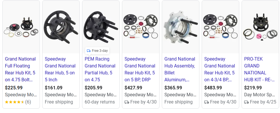

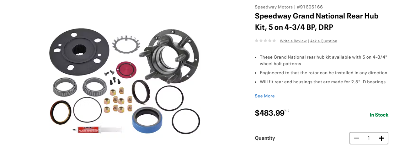

    Yes, get both.
    GN hubs can be had in 5-on-4-3/4", and stepped studs can get you from 5/8" to 1/2". Doing that gets you into WAY more wheel choices.

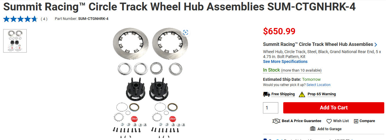

  7. Yes, Grand National hubs are now available in 5"x 3/4" however they are expensive and that only gets you part way there you still need rotors, calipers, and will need to build or buy all the all of the bracketry to make them work.
    Summit has a kit for $650.99 but you still don't have the calipers or brackets
