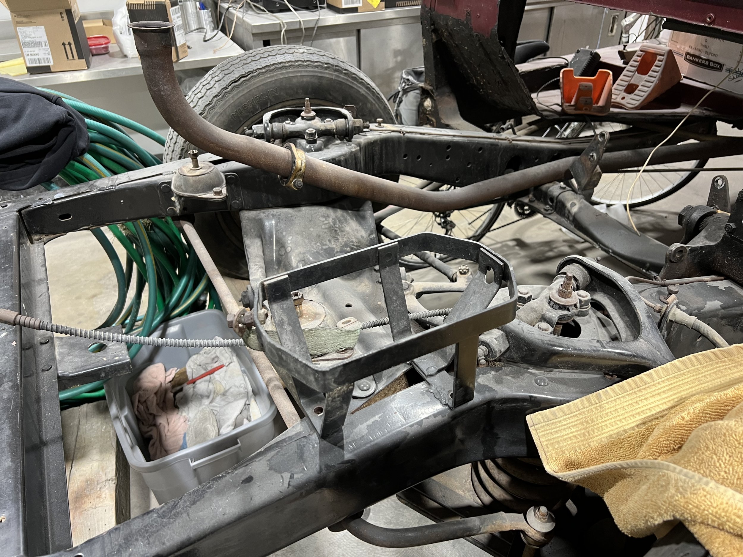

    Here is my issue. I have been looking for a longtime for a solution for a replacement for my suspension. I want Chevy bolt pattern A arm set up. The issue. Can’t find anything that will be fairly easy to install. I have pictures of my front and dimensions. Anyone has any ideas?

    That 51 Hudson has the late 30s through the mid 50s Mopar front suspension on it. They wonder because of the bias ply tires. Rebuild parts are available and are reasonably priced. They need to upper shock mount moved from the upper control arm to the frame and a larger diameter sway bar from a 1990s Jeep. There have been disc brake conversions for that suspension available for 20+ years with either GM bolt pattern rotors or Dodge bolt pattern rotors, but what ever. If you want another option that probably won't drive any better...
    Locate a front subframe from a 70s Nova or one of its GM counterparts (their frame rails are closer together then a Camero or Firebird clip), with the disc brakes. Cut off what you have there, and weld in the complete Nova subframe. It should splice in pretty close to the width of your existing frame rails.
    I have not done a Nova clip before, but it used to be one of the top go to options for many car owners that wanted the GM bolt pattern and your chosen motor will bolt right in.
    If you can't find a Nova subframe, I'm sure there is an aftermarket company that can supply you with a front suspension you can add to 2" x 4" tubing you replace your current front frame rails with.

    X2 on the Jag XJ front. Chev wheel bolt pattern and you don't have to chop the frame off

    Joining those who suggested the XJ front suspension. Find any Series I-III XJ (NOT the later XJ40, X300 or X308, those have a different rear set-up) and you'll also have the rear suspension to make the best handling Hudson on earth.
