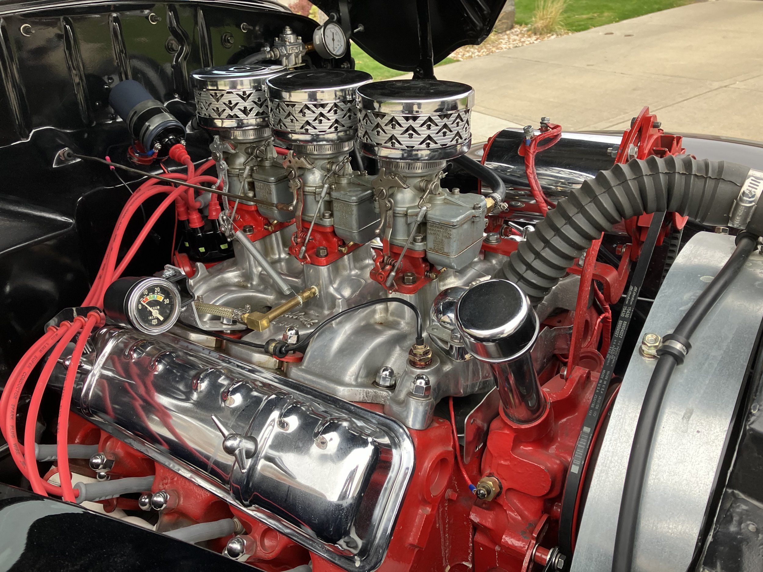

    WOW! That is very nice. I notice the "bumps" in the valve covers; that means a high-lift cam with either adjustable pushrods or rocker arms.
    If that were mine, I'd find a Mallory "flattop" for it and really have the "look".

    Thank you. He put many hours into it. If a Mallory flat top would make it run properly, I'd be all over it ;-)

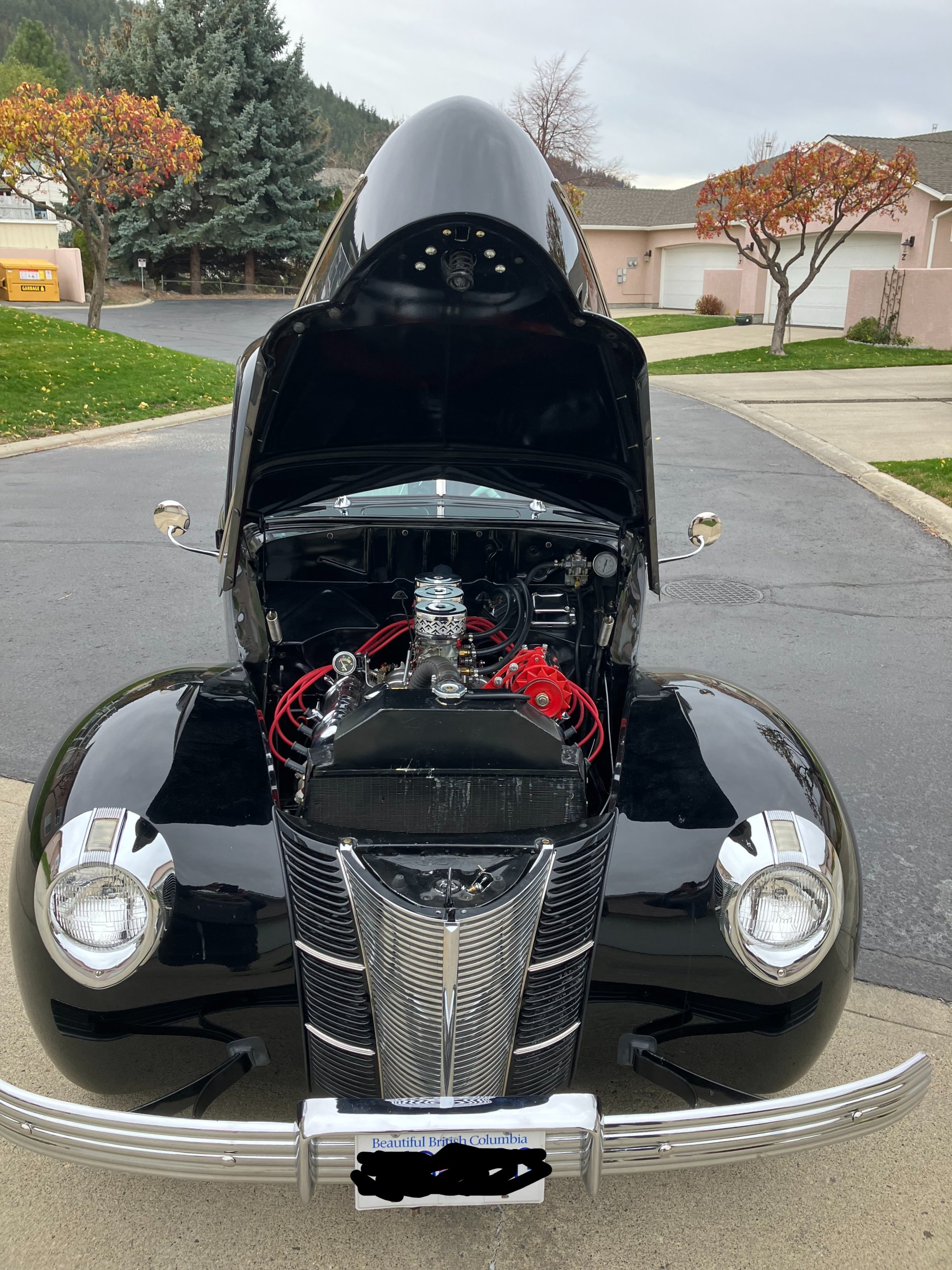

    I’m agreeing with everyone about it likely being the Pertronix. But, it could also be those front two air cleaners on upside down? :p

    I think Jeff may be on to something. Try taking them off completely and see if it makes a difference. Those things are very restrictive.
