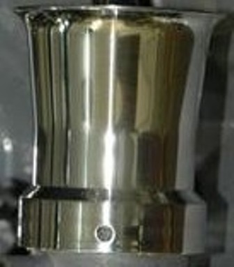

    3. As for using these throttle bodies over others that would fit easier or carb bodies - They have the basic look and shape of the weber ida which I like. Just add velocity stacks and they will look "right".

    If that's what you are looking for you don't even need the entire carburetor. Use just the carb throttle bodies, and fab you velocity stacks to bolt straight to them. The main point is that they line straight up with the intake ports. Any jog in the path is less than optimum.

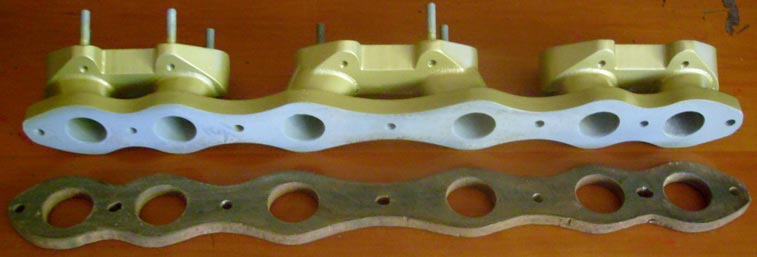

    Ok - after a lot of measuring and thought the only really viable route is "B". This is really the only way to make a clean transition and it also does not require welding on the manifold that could possibly cause some warping. I will retain the 3 bolt Stromberg mounting studs to attach. I think that will work fine.
    As much as I would have liked to go route c it just won't work with the dimensions.
    I have bought 3 aluminum billets to cut up - they are 1.5" x 3" x 6". I have laid out the basic hole locations as well as the mounting stud positions. Once it all works and fits I will try and make the adapters look a little nicer and not so "block-ish"

    making some progress on the adapters. Still have quite a bit of hand "die-grindering" to open the holes drilled through the adapter connecting the throats to manifold inlets. I ordered my velocity stacks as well.

    Updated pic - with all 3 throttle bodies in place and the velocity stacks in position. Still need to weld in the injector bungs and finish the custom air cleaner.

    It's great to see this coming together. Once you get it working and tuned it would be nice to do some radius and contour work on the exterior of the adapters to make it flow visually as well A/F wise. Mike

    That is definitely in the plans - the adapters look pretty unfinished right now.
