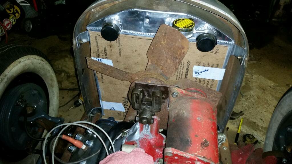

    Check out my thread-something from nothing 29 roadster build. I made a fan mount out of plate. I have a single carb intake on there but I believe it would work with a multi-cab set up too.

    What did you use to hold the shaft? I saw it but did not recognize it.

    The clamp with the two holes holds the shaft and the clamp is bolted to the plate I made.

    I got two fans from a friend. One had a fixed mounting boss, the other was clamped to the shaft. I used the clamp on one so I could slide shaft through the plate and nut and bolt the ***embly to the plate. In the first picture I had not drilled the plate yet. This set up allowed me to run one belt and still use fan mount for belt adjustment.

    If you are asking about the clamp I think it is the one that is typically used to clamp the fan shaft to the usual front mount setup but he has mounted backwards on the steel plate above in the first picture. Here is the clamp by itself.
